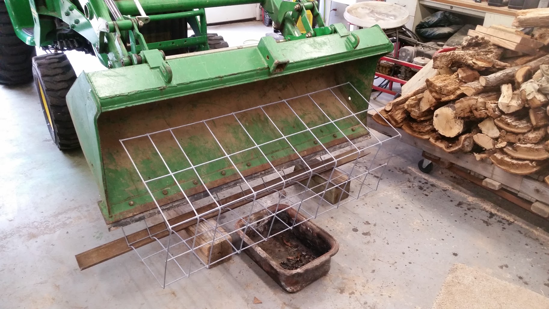

When I built my fire wood crates I parked the tractor on the cattle fence, pinned it down with the bucket, and pulled up while hitting each wire with a dead blow mallet to give it a sharper bend.
[/url]20140409_173904 by Jason, on Flickr[/IMG]

I got them bent using a piece of angle iron and the bucket serving as a wedge. It worked okay. After the three bends I still had to touch some up with a hammer a little bit because of the bends being so close together. The chipmunks and squirrels will never know the difference.
