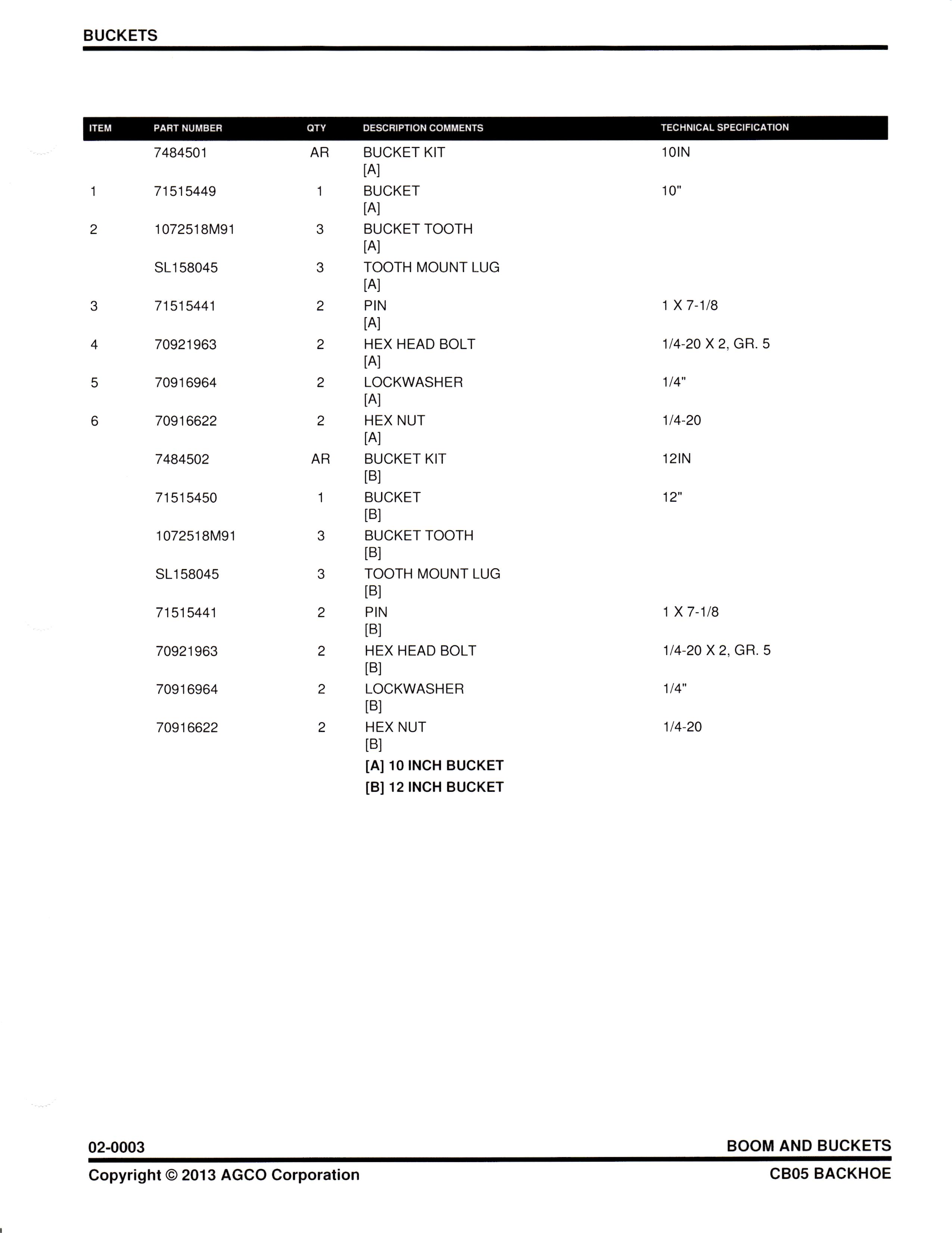

If I had someone that wants one for a CB05 that has a Caliper and is willing to work with me on measurements I could make one.
I do not think there is one for the CBO5 right now.
Petrified sounds like rock to me and it would not work good on rocks.
My Quick Connect will work with BX trenching bucket.
Here is a picture a customer posted to FB.

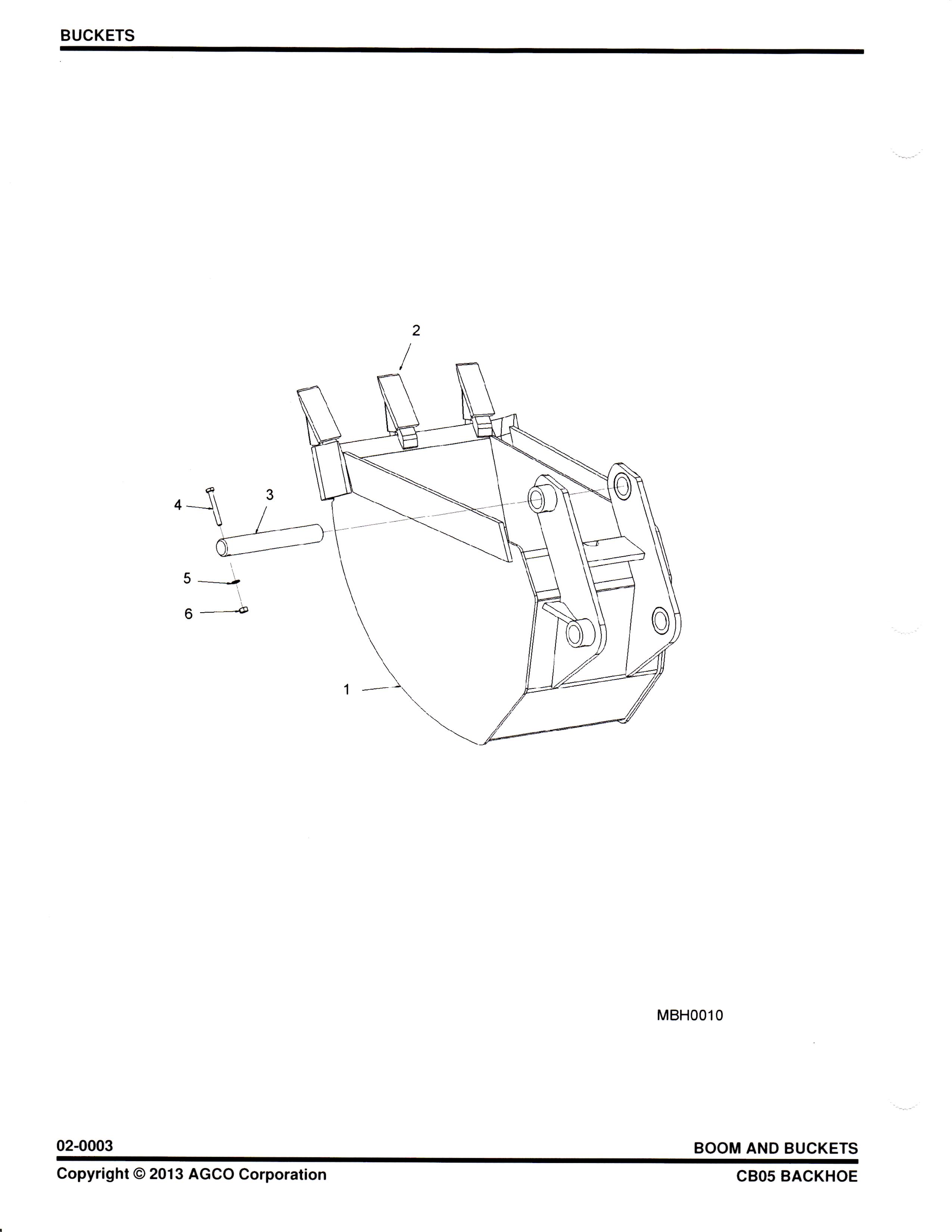

Sorry, I forgot to get the pins size for my CB05 Backhoe bucket to you.
The pins are 1" diameter x 7.125" long.
Below are copies from my CB05 Backhoe Parts Catalog:
KC
