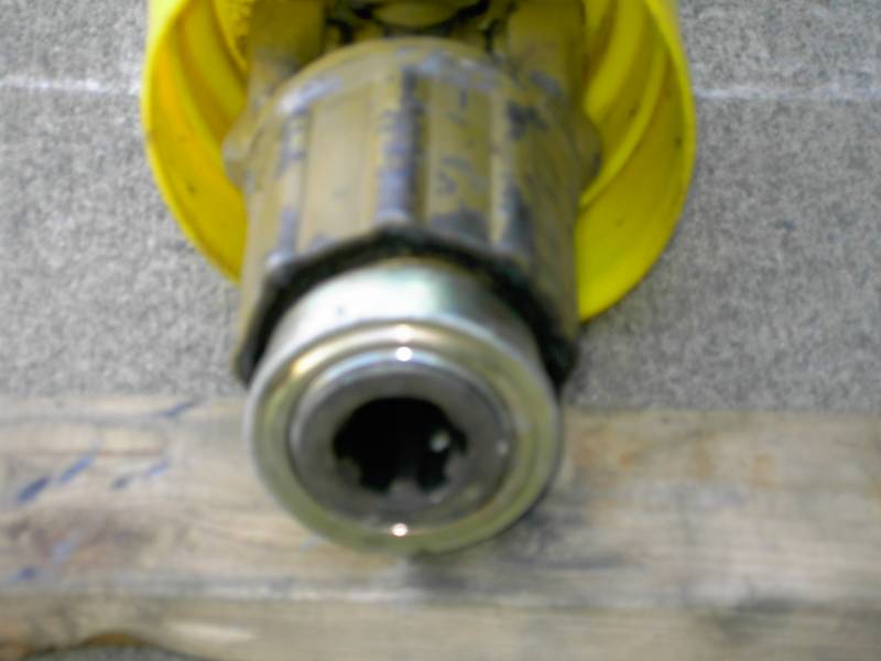

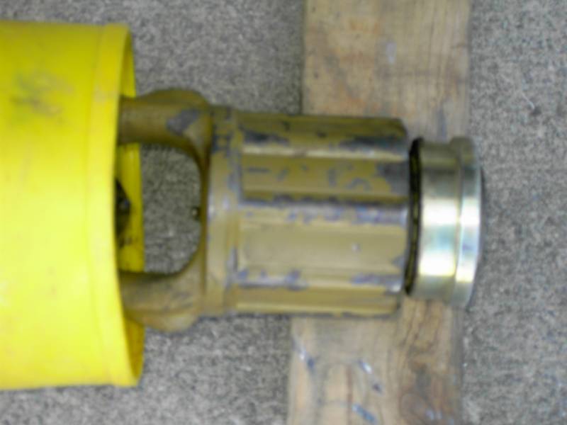

Slip clutch adjustment?? Don't know about yours but mine came with a "ratchet" type and I prefer it as I don't have to mess with it every year or less, hook up and go!

Do you have any pictures?
The only ratchet clutch I've seen is an over-run clutch for tractors without a live pto.
   / CCM Tiller weight claim? #14
"Rachet" may not be the correct technical name for it (Mark could straighten me out on this) but here's a couple of pics of it.
   / CCM Tiller weight claim? #15
I believe it is called a "radial pin clutch" according to Mark at CCM. It is a bear to take off the tractor PTO stub. Any suggestions? I use a tow strap attached to my 4WD pickup currently :(. Jay
   / CCM Tiller weight claim? #16
We use them on hay tedders and they go on the implement end. Our tillers have the slip clutch at the implement end also--Ken Sweet

sweettractors/Ken Sweet:
The more I thought about my post the more I felt that I should reverse my PTO drivelines. Your post reinforced my new "sense of direction". I will switch my PTO drivelines around once I get my little bugger "clutch" off my tractor PTO stub. The yokes on both ends are 1-3/8" compatible. I will try to make the "switcheroo" sometime this weekend. I set this up originally due to my "interpretation" of the translated manual. Jay
