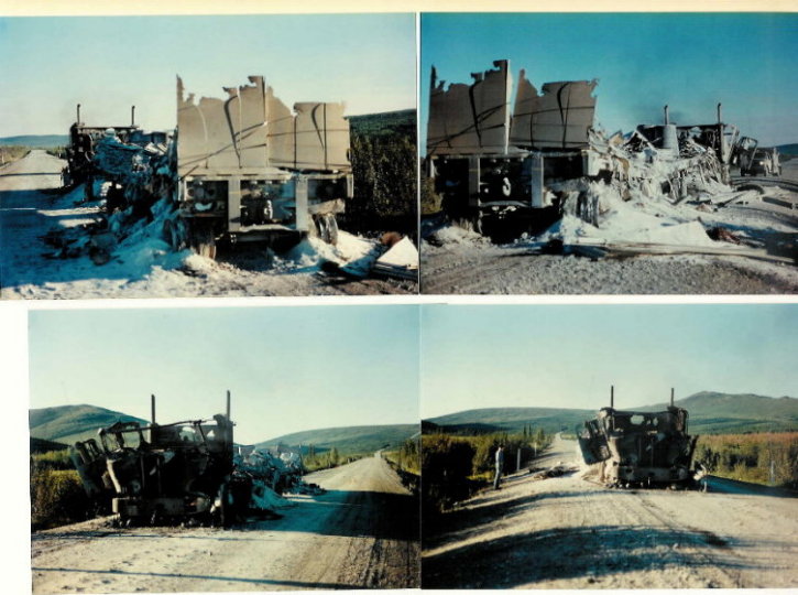

I guess that's a possibility although I find it a little hard to believe anyone would attempt that trip in a big truck without a Jack Brake. And of course we could only speculate as to the cause of the fire since there was no one around and no kind of services in either direction for a hundred miles and the truck was sitting on level ground at the bottom of that long steep hill. We had gone up the day before (July 4, 1991, weekend) and of course that truck wasn't there then.
Since that road was not open to the public, there were no weight limits at all. They had a staging area at the south end where they could assemble and load anything they thought they could handle. The oddest thing we saw (and was sure sorry I didn't get a picture) was a completely assembled drilling tower standing upright on a low boy truck. I don't know how tall it was, but am sure it was well over 50' tall. We met that rig as we were coming back, too, and of course he asked on the radio what the road was like behind us (rub board for 125 miles /forums/images/graemlins/frown.gif. We were doing 15 mph and rattling our teeth, he said he hoped to make 10 mph).
