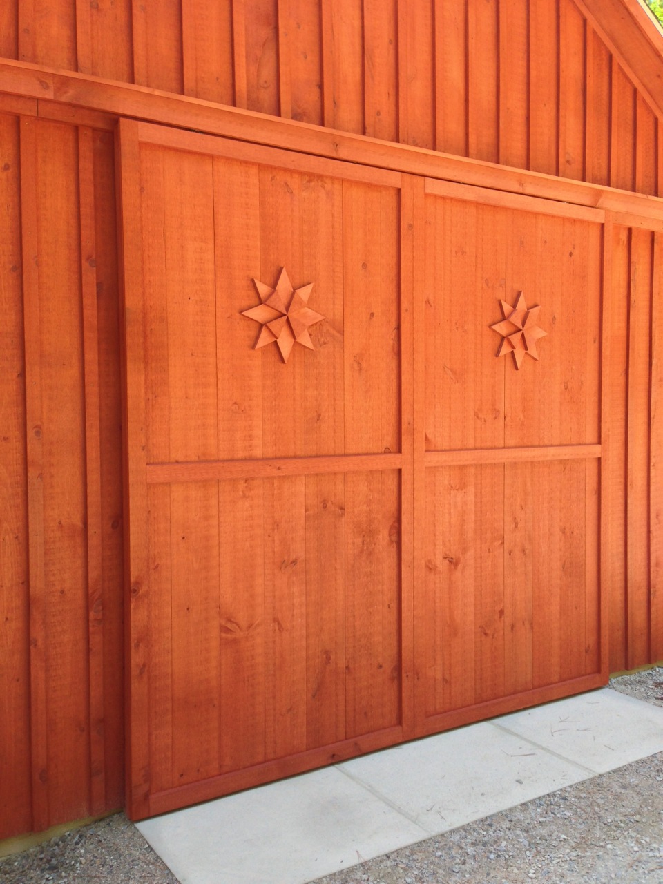

CHA pole barns (out of PA) used white pine board/batten siding on my barn, and it was really nice wood. Stable with a tight grain and well seasoned, so it cut and nailed very nicely (don't recall a single piece splitting on us). For doors I just did a lap joint, and the joints have stayed nice and tight. I'd say it's some of the nicest softwood I have worked with in a long time.
I don't know the source, but Carter lumber (also in PA) delivered the siding, so they would know. I may still have one of the tarps that covered the stack and will check to see if it has more info. The boards are about 9-1/4" wide, about 3/4" thick, and have one side with a milled "rough" finish. It takes stain very well. I am about halfway done staining it with Sherwin-Williams Woodscapes stain, in red.
   / Cedar siding question for new barn #19
By the way, you can greatly increase the rot resistance of wood siding by putting a 12-15 degree slope on top of any horizontal trim piece and caulking the joint where it meets the siding. I did that on the middle and bottom cross pieces on the doors. It's not really noticeable, but prevents water from collecting and getting in the joint.

CHA pole barns (out of PA) used white pine board/batten siding on my barn, and it was really nice wood. Stable with a tight grain and well seasoned, so it cut and nailed very nicely (don't recall a single piece splitting on us). For doors I just did a lap joint, and the joints have stayed nice and tight. I'd say it's some of the nicest softwood I have worked with in a long time. I don't know the source, but Carter lumber (also in PA) delivered the siding, so they would know. I may still have one of the tarps that covered the stack and will check to see if it has more info. The boards are about 9-1/4" wide, about 3/4" thick, and have one side with a milled "rough" finish. It takes stain very well. I am about halfway done staining it with Sherwin-Williams Woodscapes stain, in red. <img src="http://www.tractorbynet.com/forums/files/projects/386970-cedar-siding-question-new-barn-img_4618-jpg"/>
That looks great. My guy wants to use rough cut pine so may just proceed with that route. Thanks
