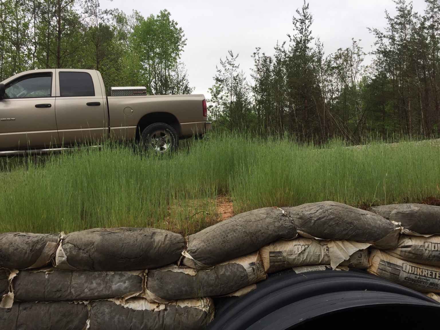

Took this picture of the oats growing last week.

There are definitely cracks. Depending on where you plan to use this method, that might be aesthetically unacceptable. For me, it wasn't. I used Quickcrete which does not have a plastic liner to the bag as sakrete does. My biggest challenge was that we had a drought this fall and there was very little rain. I ended pouring buckets of water across the bags from the pond. Not a great solution. I also used a trash pump to pump water onto the the bags. This works very well after the bags have hardened, to quickly remove some of the paper. My biggest concern about cracks is freeze expansion. I will have to wait to see how that plays out. As for stability, the wall is rock solid. The bridge is also absolutely stable. I have driven my excavator and tractor back and forth across it hundreds of times. Pickup truck. Gravel trucks (somewhere around 50,000 lbs loaded). A truck pulling my travel camper. My bridge is solid and in the 1 or 2 significant rain events that we have had, the overflow goes down the culvert and hasn't been higher than 4 inches. Also, I poked larger holes in the bags to allow water to get in, because even a paper bag will shed water once it is saturated. I will use block in other walls I build, because they are near the house....but I wouldn't hesitate to use this material again.
As for lessons learned....have the cement delivered to the job site. Having to move the first batch of 3-400 bags 1/4 mile was just stupid.

I got to see it perform in a sustained hard rain. Superb performance. Everything was exactly as planned and it handled the water easily.
