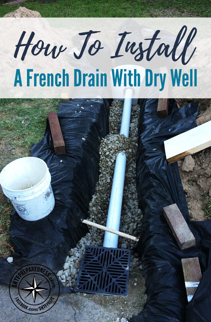

You could help your neighbor dig a dry well on his property with french drain...:)

What is the soil like? If you can dig down to a sandy base layer, you should be able to help the water percolate down quicker and avoid standing water and puddles. I know of a couple folks that have done that in low spots on their property. One guy dug it all by hand and went through 6' of clay before he got to the sand (I don't have the fortitude to dig that deep in clay and would have rented a backhoe).
On my property, we have 2-4' of clay and then it is really nice sand below that percs very well. If I had a low spot somewhere that was collecting water, I would wait until the area was dry enough to get a backhoe in, then dig a hole down to sand, line with septic paper, refill with #57 gravel, and then cover that with septic paper and replace the sod layer.
