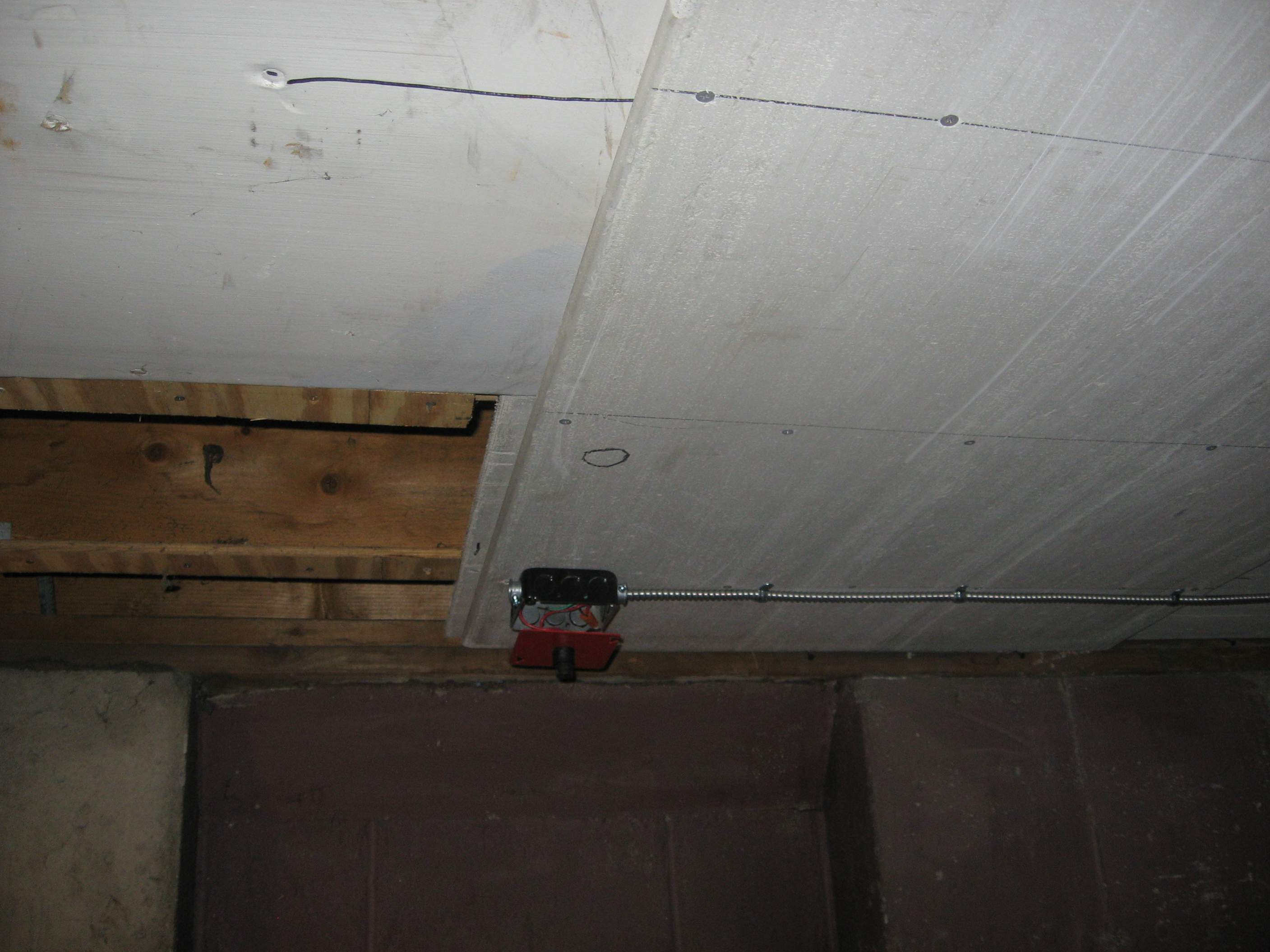

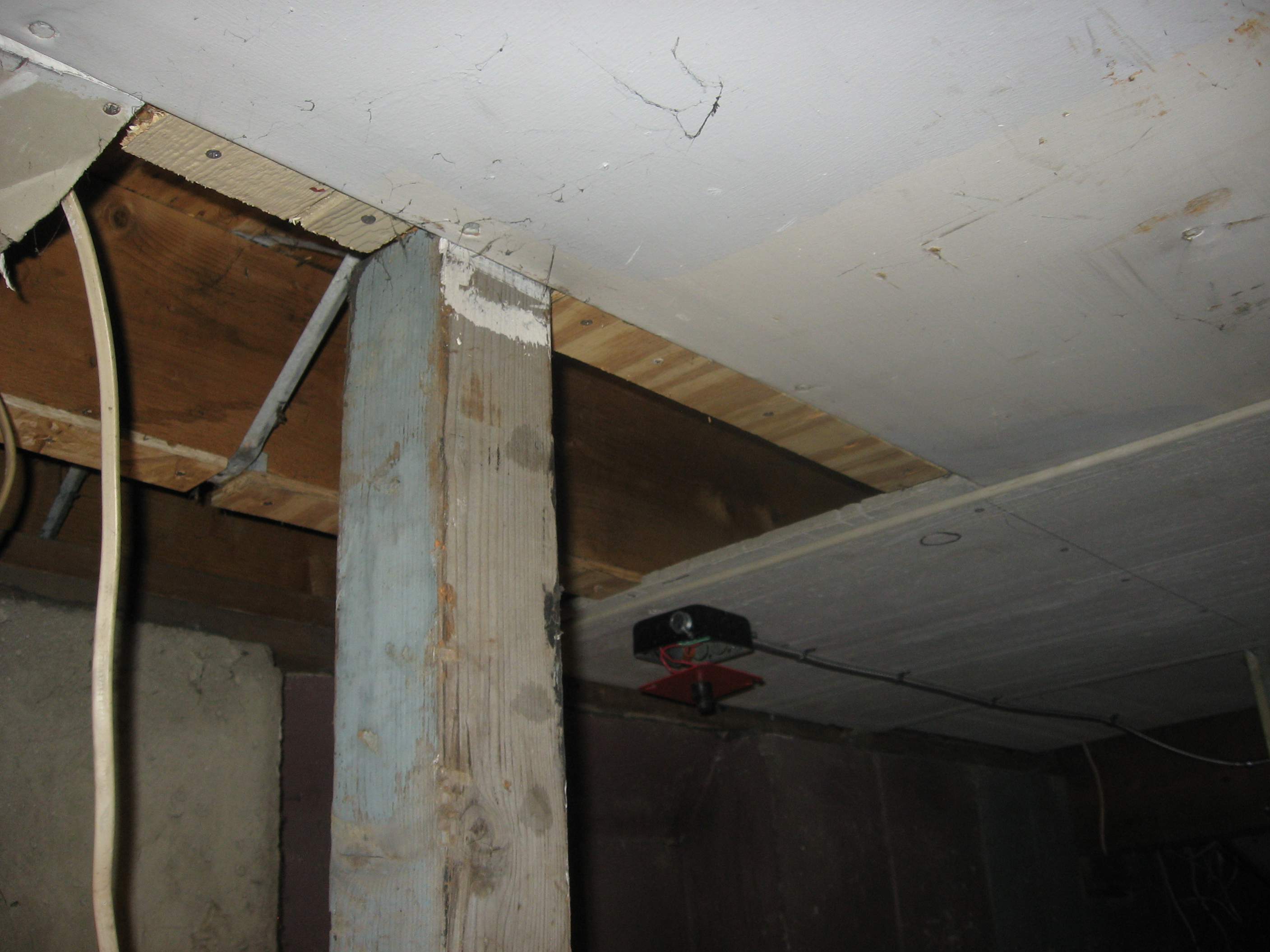

Just to update and to maybe clarify the reason i was looking to add this is. I already had 5/8 drywall over the wood furnace. and a small section of it extended over the oil furnace. in the back section there was nothing at all just open floor joists. My in intention was to add some sort of fire shield more than a concern for the heat.I used 1/2 in rockboard and the special screws. Went up easy and used plenty of screws so I doubt it will sag at all.
Both of these don't get as hot as they would if it were a straight wood stove with the heat. The higher heat is blown through the ducks so the ceilng temp is lower 1.jpg3.jpg
