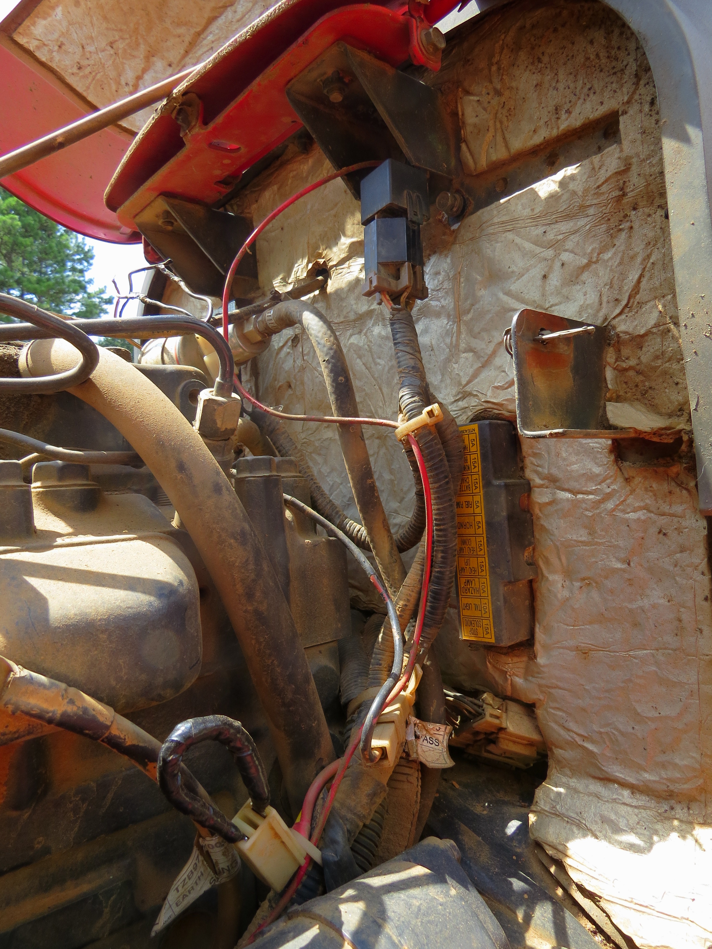

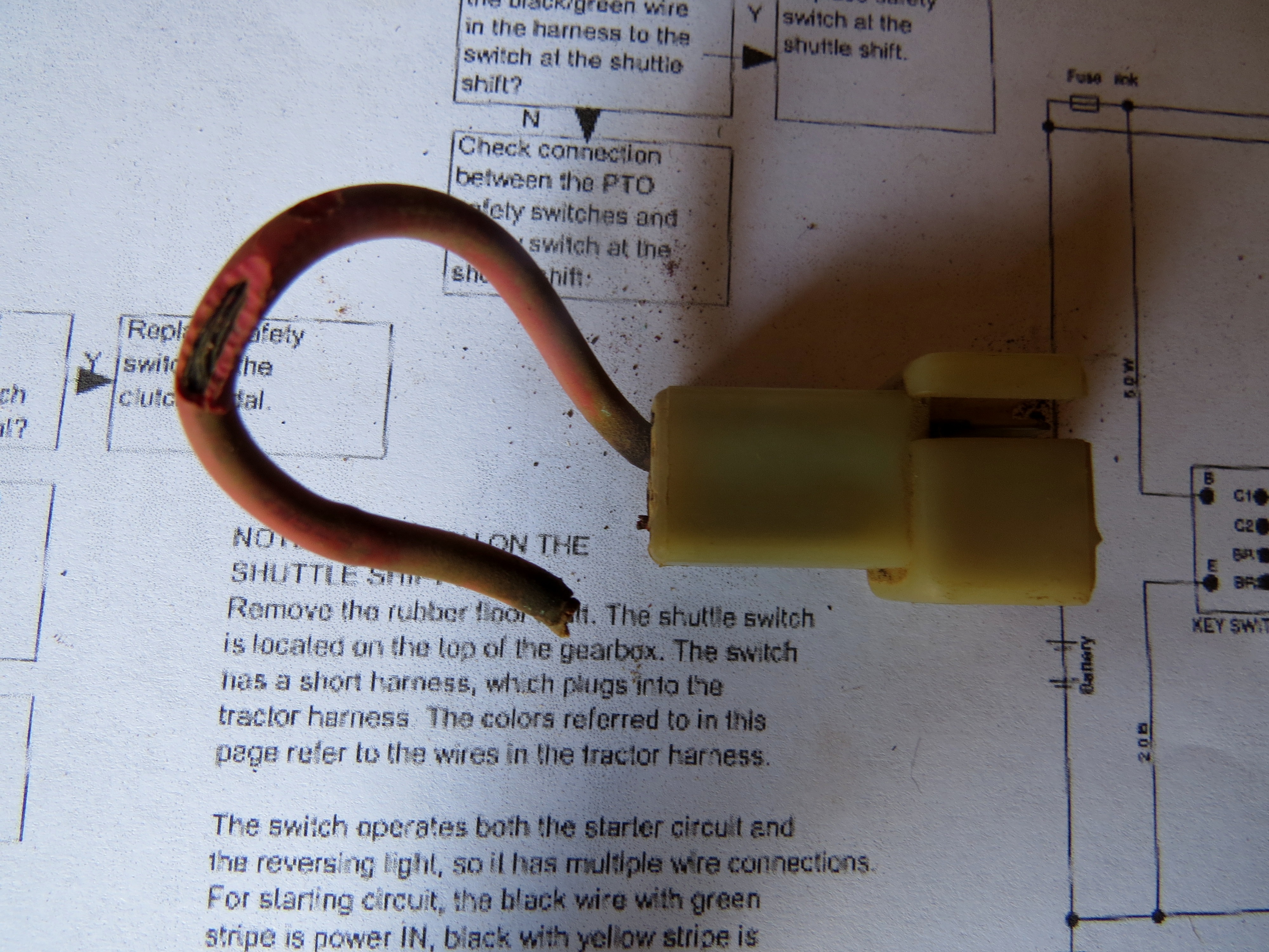

After reviewing the information I received, I found what I think is the fusible link. In the photo, you can see where the plastic is worn away and the copper wire exposed. This was resting against the back of my starter. When I took it off, I found that the wire at both ends was fried. You can see the discoloration in the picture.
I made a temporary jumper to see if that was it and if I could start it. Nothing. It's still dead. The next place I checked is at the top of the picture. I'm calling it a starter relay, but I don't know if that's correct. Please help if it's called something else, since that's what I'm searching for online right now.
Here's another picture of what I think is the Starter Relay. There is a large yellow wire going to it with 13 volts. There are three wires leaving it that do not have any voltage. I checked for continuity on the relay starting where the hot wire goes and there isn't any electricity going through the relay. Does that mean it's bad?
Or is this a Glow Plug Relay?

We had an old converted electric car, 16 golf cart batteries, we'd have to put 1 to 2 relays into it yearly. That's where I would place my bet on...
