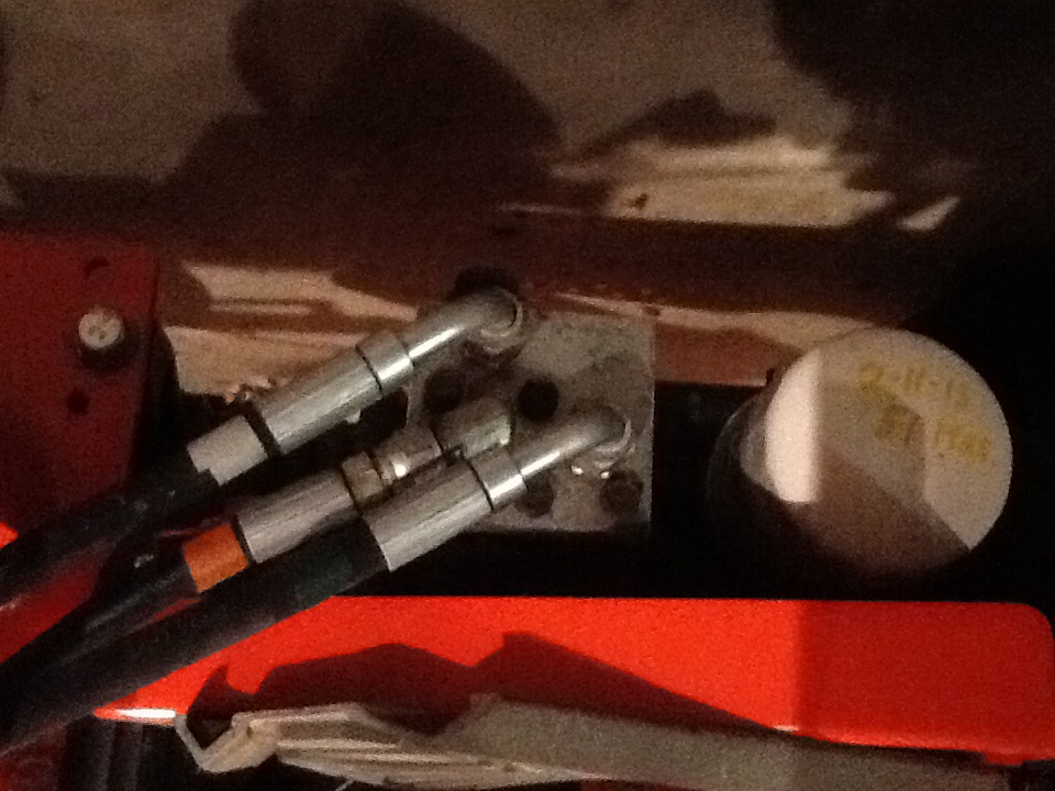

Ok, thanks. JJ. Just to verify that I have the installation right.
PB hose from hydraulic block to new valve inlet, PB screw into C port, then new hose from C port back to hydraulic block PB where first hose was removed, then hose from valve outlet to hydraulic block teed into existing return line.
That should work.
Can you post a picture of your hyd block.

Here goes
   / Cessna 3 Spool Control Valve #16
If I remember correctly, the orange taped hose is the flow from pump.
White is the return /OUT flow from FEL.
The left port is the PB flow from the FEL.

That is my understanding also. Thanks very much for your help. I hope to receive the valve today. I just got through unloading my new grapple which was delivered this morning.
