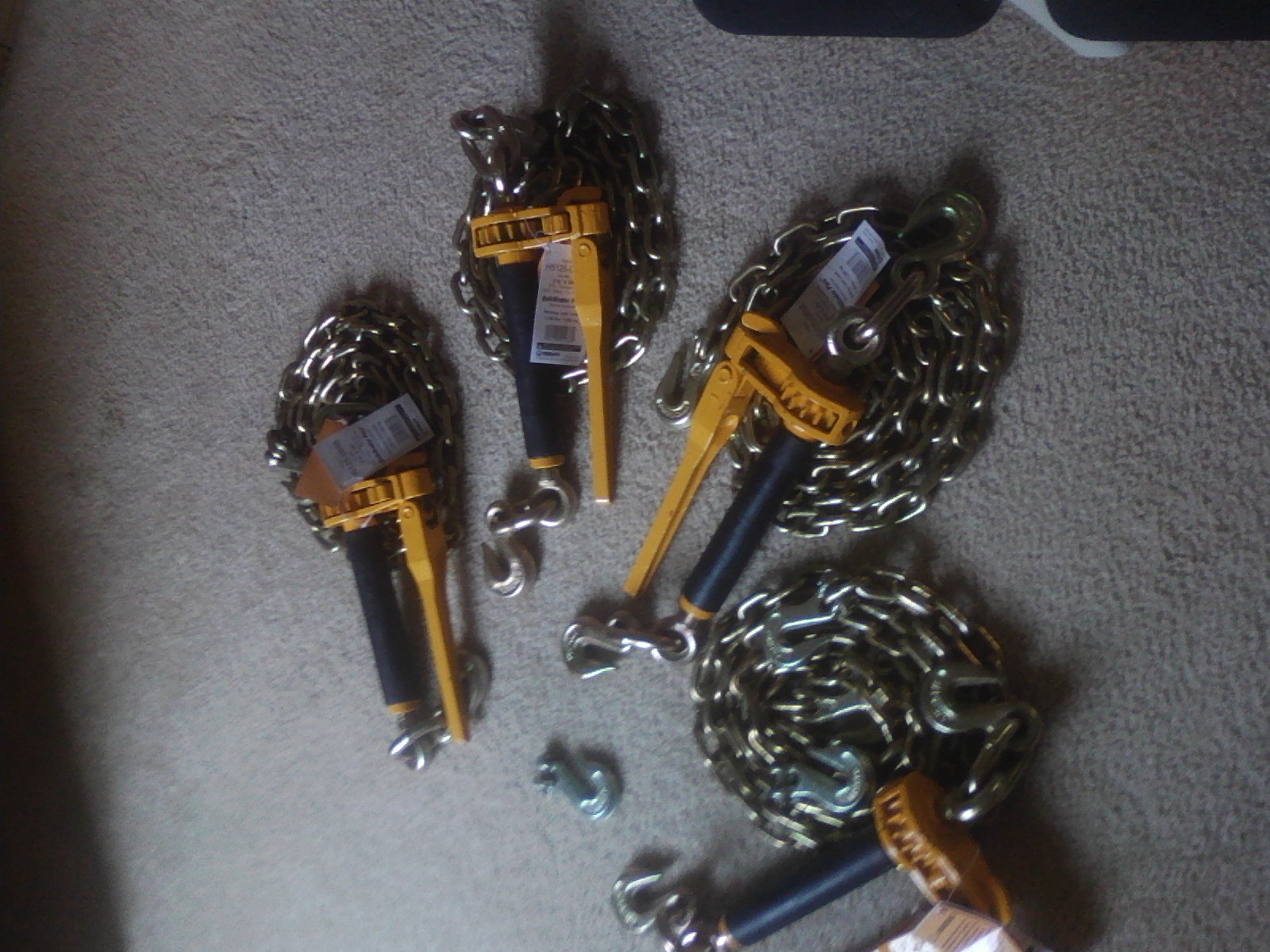

Truck and tow has a free shipping offer currently, and I want to confirm what I am getting.
They have folding handle ratchet binders (grade 80 for 5/16 - 3/8 ) and I was going to get 2 - 20' 5/16 grade 70 chains and cut them to 10' along with two hooks. I called them and they were very helpful confirming what I need to get and answered questions well. No sales push. A+ in my book. On thing that also caught my attention is that have 2 listing for grade 70, plane and transport grade. Tie Down Transport Chain | Truck n Tow.com The transport grade is US or Canadian made. The grade 70 can be either including China or other off shore sources. For those of you that know is the value of US made better. I have heard the coating holds up better. I'm willing to pay a bit extra for quality if it is there. Thoughts?
Background - I hauling a 3600 lb tractor and Baler which I think is 3000lbs, so 5/16 should keep me DOT legal.

Well I found a better deal than Truck & Tow here Wholesale Rigging Supplier - Rigging Equipment Supplier | Murphy Industrial Products They have a first time buyer coupon 7% off, and free shipping right now. Saves about $50 over the next lowest. Same quality and items.
Now CSP wont be stopping me for the wrong chain grade :D
Got stooped last week after posting this at one of the quick safety inspection stations. No fine, I had it secured, but they just told me that I needed grade 70 or better chain and binders.

Talk about customer service. I got a voice mail late Friday that they were sorry that one item was not in stock and due in next week. They could ship everything now and the other binder later, but were asking if I could wait. I called the number they left this morning and talked to them. Told them it was fine to wait to and ship together. I also asked if the second order could be included as I forgot I needed two more clevis hooks to make 10 footers out of the 20 footers I ordered. They said they would do the fabrication for me at no costs. Great folks to work with. Only down side is now I wont have to mess anything up fabricating :confused3::confused2::laughing: I was so looking forward to using my angle grinder and pinching or burning my fingers.
   / Chain and Chain binders - best place to get or make my own?
#20
Package arrived today. No damage and good looking stuff - they even did the fabrication to 10' and included an extra clevis. Great folks
Added a photo
