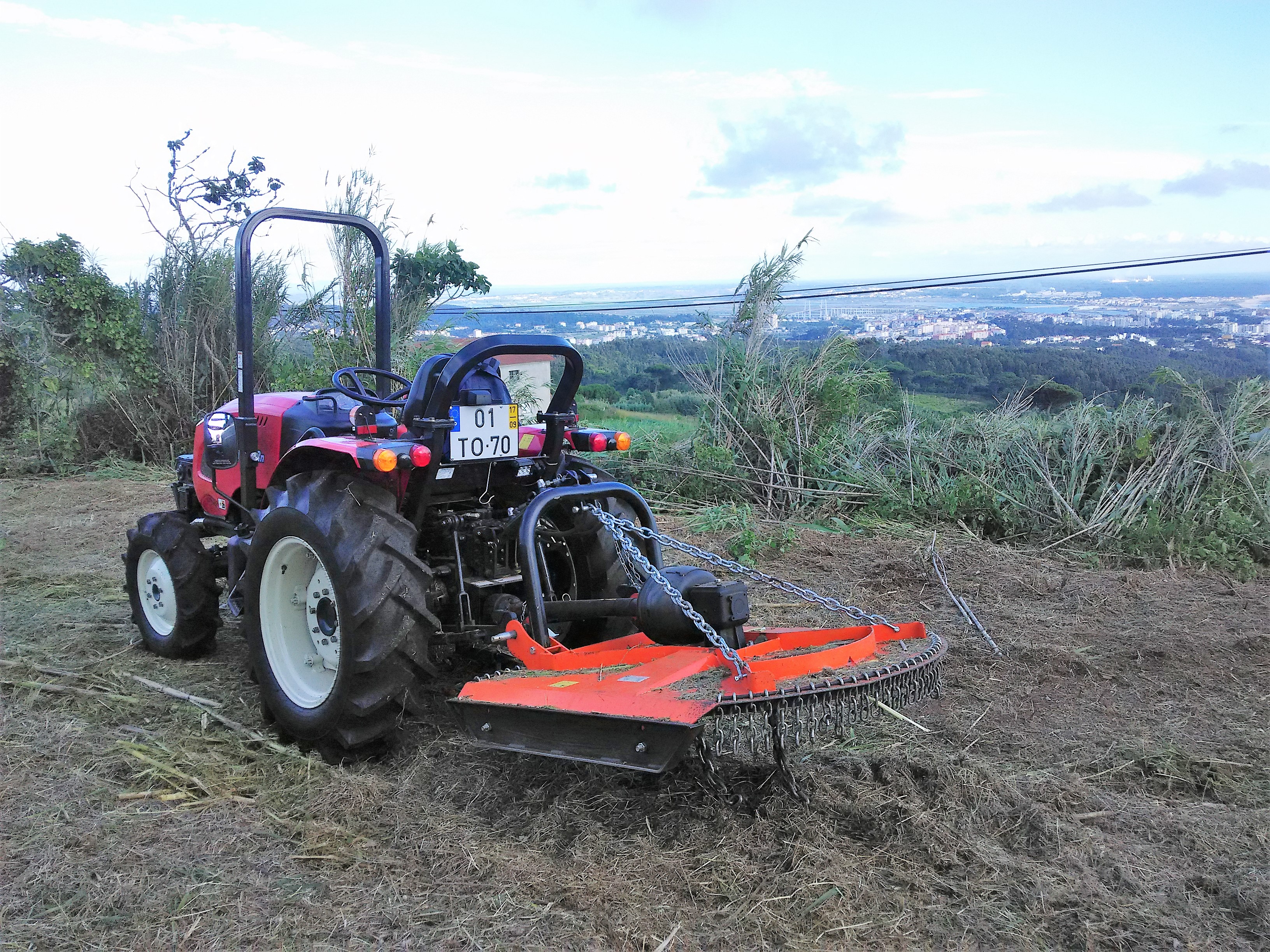

Over here the brush mowers use chains on the hitch. I have a hydraulic top link, so I just extend it to the max and let the mower float. We also use high strength chains for the cutter instead of blades.
Some people will just disconnet the top link ant let it move however it wants. But if you forget about it and lift the 3 pt hitch too high, it can damage the PTO shaft as it can hit the mower base.
Here is a quick timelapse where the floating acting is visible.
