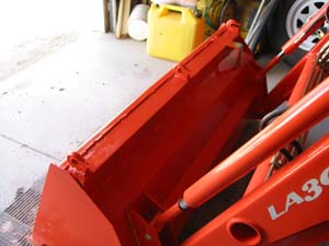

Welded 3 hooks to a piece of 3 x3 angle. Welded angle to bucket body and top curl as well as both end plates. Don't think I have to worry about bending the bucket. Load is spread out over whole top frame. Welds across angle are about a inch long and spaced about 4 or 5 inches apart to minimize warpage to bucket.
Hope this is some help.
Malibu

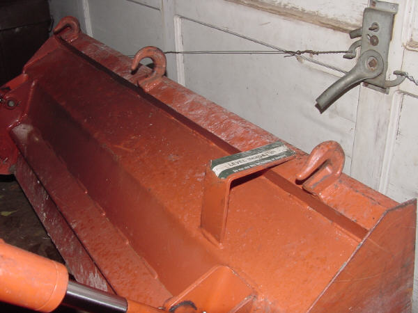

You're getting lot's of good responses here. I thought I'd add my experience here too. My dealer installed mine and put 2 chain hooks on and a larger hook in the center. I like this setup because I can use the center hook for larger diameter rope, etc.
Just another approach. Picture attached.
Greg

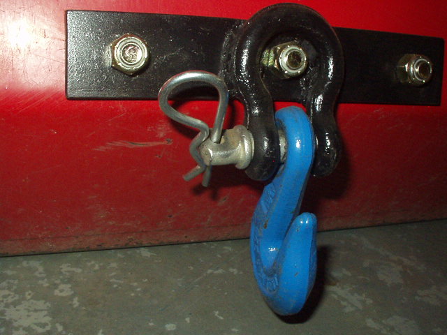

I've been impressed with the ingenuity found here. I just installed a hook on the back side of the bucket on my MF 1240. Its a little different approach, I welded a clevis to a piece of 1/4" flat stock, then bolted it in the same plane as the flat back side of the bucket for strength. The clevis allows the hook to pivot and its also removable.

YOU get the prize for ingenuity here since you can interchange different hook sizes and styles.
John
One very minor point about prominent hooks on the bucket lip that I found out the hard way: If you invert the bucket to stabilize the front when backhoeing, the hooks grind into the pavement.
