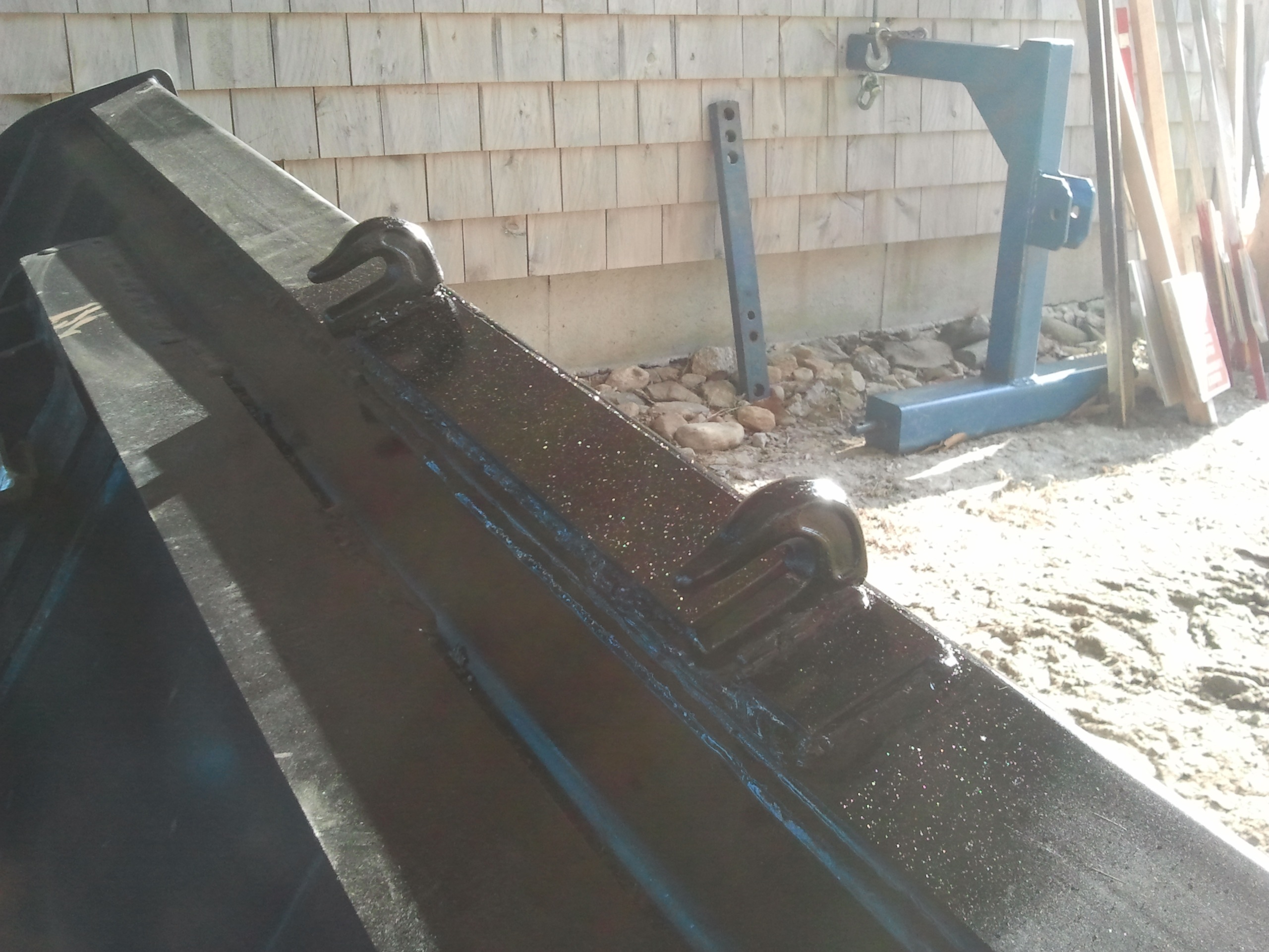

I have used Ken's 5/16" bolt-on grab hooks for almost three years.
Easy to install. (Buy the two drill bits required, new, for the job.)
Immovable.
Indestructable.
Industrial Art.
Ken's Bolt on Grab Hooks <<Home>>
The one on the right side of the bucket (when sitting in the seat) is crooked. JMHO :laughing:

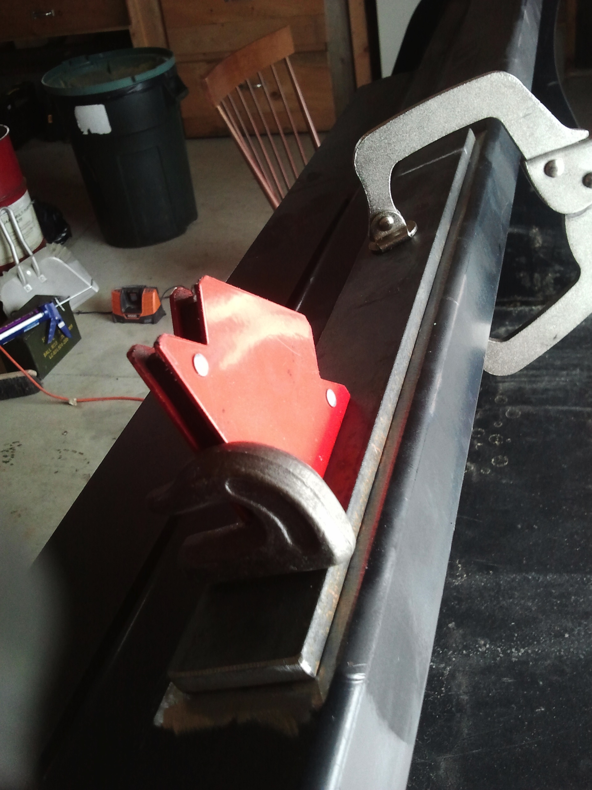

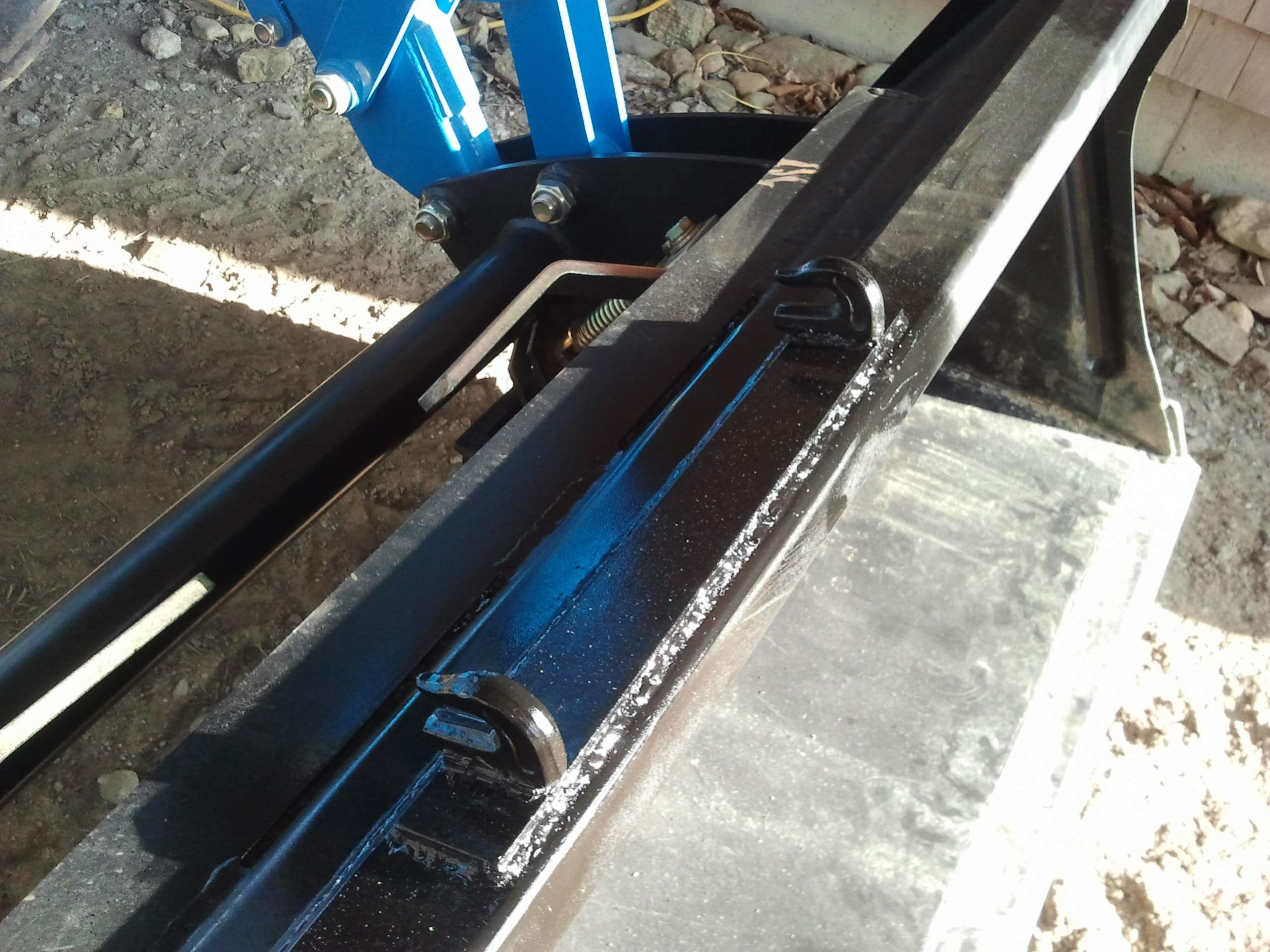

I did it this way:
Weld a 3/8" 2"x18" piece of steel in the middle to act as a strengthener.
Then weld a couple of hooks to the outside of that.
I wanted them nearer the middle. I'm thinking that lifting a heavy weight off to one side might tweak the loader arms.
