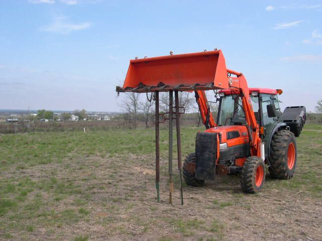

Chain hooks visible on top of bucket. three T post driver/sheaths of different lengths for different length T posts.

TexasJohn- Any chance of a pic. I am interested in the post driver system you have setup. I think I got a pretty good idea of what you are talking about but a pic would be cool.
