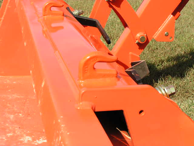

Because I was welding outside at the time, I used my stick welder to weld some chain hooks on my bucket. Many people underestimate the strength of 6013 rods. Sure there are stronger rods, but it would take a lot to need them. I even used 6013 rods when welding some grab hooks on a 955 Cat I had. I never managed to bend them or break them off. And, I did get that 955 buried a few times. More than likely, you'd break something other than the hooks. Here is a pic of the weld on grab hooks welded with 6013 rods. They are welded to a 1/4" piece and in 2 years of yanking, I have not even bent one. Good luck!
