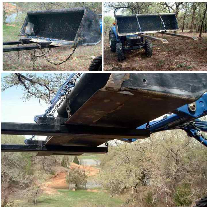

I bought my chain-on forks many years ago from my NH dealer for $250. They are plenty strong and I have just three complaints about them. The first complaint is probably not the fault of my forks, but rather the binders.
1. The over-center binders are either too tight or too loose. If I get one tight and then put the other one on, the first one loosens because the bucket lip will flex up a fraction of an inch. I need rachet binders; not the fault of the forks.
2. The forks need a wide piece where they attach to the bucket lip so they do not move side-to-side. Even when tight, if the tips get a side load, they move. An adjustable "stay" between the forks right in front of the bucket lip would be ideal, but = more cost.
3. That darn bucket is smack dab in your needed field of view. It also extends the tips out where the rotational radius is multiplied to the point that the tips move several inches for a tiny movement of the bucket curl. So you are working in the blind and fine control is almost impossible. I recently unloaded several pallets off a truck and could bend down and see below the bucket as I forked the pallets. But even at that, I didn't like the lack of fine control or my view from the tractor seat.
All chain-on or clamp on forks are better than nothing, but I think I've become frustrated enough with these to just pop for a $700 set of quick-attach pallet forks and be done with it.:rolleyes:

   / Chain On Pallet Forks Came Today. #16
D-D, I surely understand your disappointment. It's clear that the forks DO NOT serve your needs at all. Although they do serve my needs okay, I'm thinking that QA forks like jinman is talking about is exactly what you need.
I would have hoped that the seller would have understood that as well, and given you a full refund including return freight. If he isn't interested in making you happy, I support your actions completely. After all, it is your hard earned money, and he did not fully describe the forks.
jinman, I have exactly the same problem that you except I don't have bucket flex. And that's because I added a 3/8" flat bar all the way across mine when I added hooks. Nothing looks worse than a warped up bucket.
I love the little ratchet binders though. They're light enough to handle with one hand, and strong enough to do the job. But, at $25/each, they're no bargain for sure.
I'd love to have a set of 48" flat forks with a QA, but these do fine for what I use them for, and at a decen't price. And, I do have available some drill stem pipe and 2 x 4 heavy wall steel tubing. If I need another set, I can make them for next to nothing.
