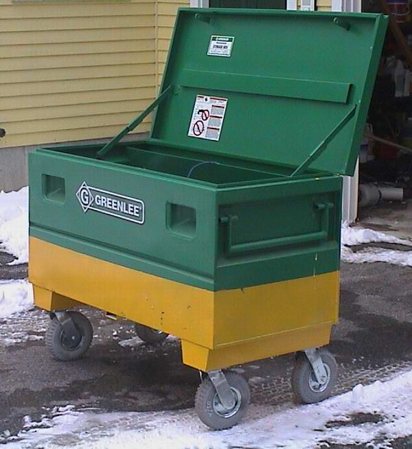

I took a Job Box and added 10 inch casters.
I can now load the job box up with my chain saw, spare chain, spare bar, gas, bar oil, hand saw, bypass clippers, chains, cell phone, a radio, tool box ....
I carry the box out to work with my clamp on loader forks, and once I am out in the field I roll it around on its wheels while I work.
In the garage the top of the job box provides extra work bench space.

Possible to post a picture of the job box? Interested in how you do that.

This is a photo of the job box.
