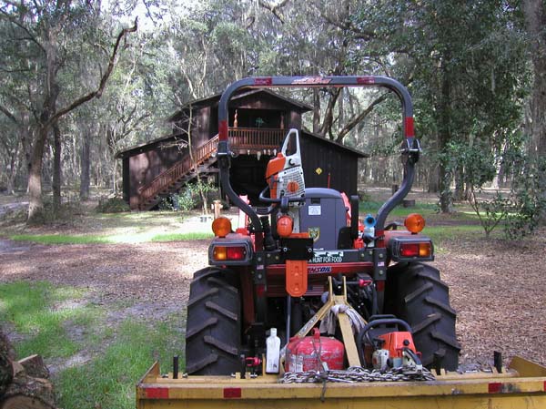

As difficult as it is to carry around a chainsaw on a tractor, this bolt on setup from Cabela's works great. /forums/images/graemlins/wink.gif
It is made to fit on ATV's but adding longer U-bolts to the carrier allows it to be attached to the ROPS easily. I can also carry a spare saw and fuel tank on the boxblade after bolting on a couple of pressure treated 2"X8" sections to the top of the box as seen in the photo.
Mounting on the rear ROPS keeps the saw out of the way allowing a good operational visual field, as well as keeping it from getting smashed from any attachments or trees, etc.

Does the weight of the saw rest on the tip of the bar as the bar sits in the orange scabbard? I can't quite tell from the photo.
   / Chain Saw Attachment for Tractor
Sorry about that.

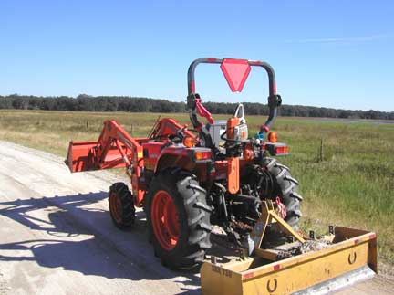

The orange scabbard is just the typical Stihl bar and chain protector.
In the first attachment pic I only originally had a short 12 inch orange scabbard, however I later got a full 24" one to allow the entire saw to fit down into it all the way.
What is holding the saw is the black metal section that has two 1/2" bolts through it to clamp down onto the orange plastic protector surrounding the chain saw bar & chain. It is coated on the inside a with thick spongey plastic covering to prevent vibration and loosening.
