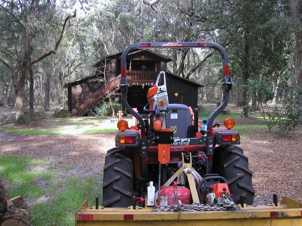

When I first put this together I was worried about the scabbards hitting the front tires, but I'm happy to report that it works fine with no collisions.
However, I'm picking up a new saw in a few days with a 28" bar, and it will surely protrude out the bottom of the scabbard, so I might be right back to having the tire collision problem. I'll let you know later next week.

I don't think it would fall out (the chain bites into the wood a bit and have to lift it when removing) on any hill that I would attempt to go up forward. It has been very handy to take with me, and not in the way when operating the tractor, now that I have used it awhile.

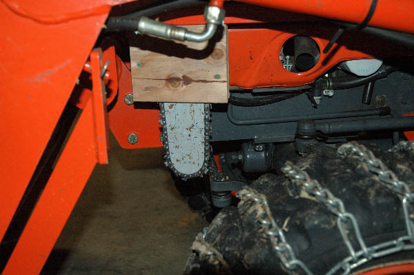

Yup, the 28" bar hangs down too low and hits the front wheel in certain positions. See attached picture. I'm going to try angling the scabbard to get more clearance and to get the bar tip further behind the front wheel. The only other option is to raise the whole thing up higher, but that will place the saw powerhead right in my line of sight when driving, so I'd rather avoid that.
