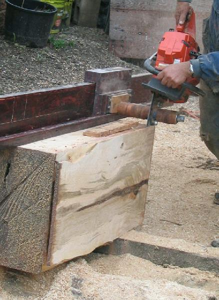

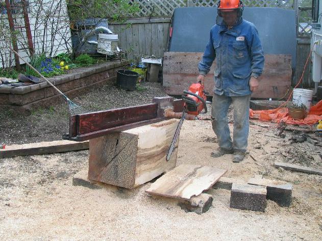

I use a simple homebuilt device to cut logs into lumber with. It's sorta like a beam machine. Picture attached.:D

Good God Egon. I'm sure there is no warping in your beam. How do you get it onto the log? Looks like it takes about 2 men and a bulldog. :D Great tool and I'm sure from your woodworking post it works.
Thanks for sharing it, EL.
   / Chain saw mounted sawmills #13
The beam is not all that heavy. It is made from 3/4 inch plywood. It screws onto the log.

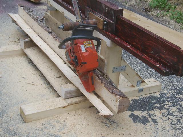

I have also made a frame for smaller logs so they could be squared up. picture attached.:D :D

Thanks Egon. Now that I can see it more clearly it makes sense. At first I thought it was a slightly rusted I beam you had modified. :rolleyes:
That is what is so great about the members & guest on this site...everyone has a question and someone else has already been there and are willing to share. :D Thank you, EL.
