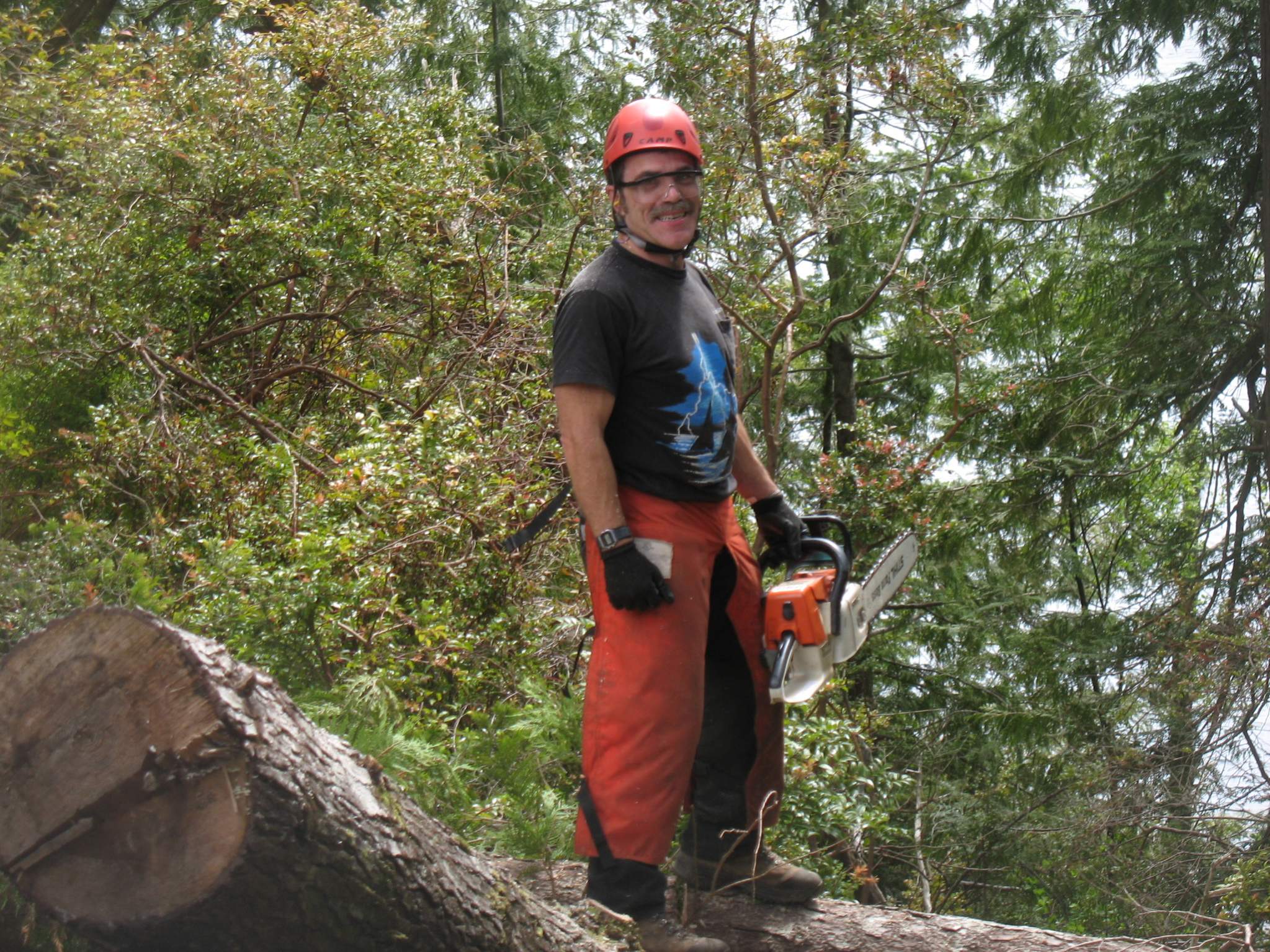

A couple of shots working up volunteering on an Island in Canada.. Notice the chainsaw chaps helmet and glasses.. You cut yourself open on an island that is a two hour boat ride from an ambulance could be a bad day.
I respect you for your volunteering efforts. Safety should always be considered when using a chainsaw, but being located such a long distance from a medical facility, would surely be a viable concern. It would surely be beneficial for everyone to attend a seminar such as was described, if possible.
   / Chain saw safety seminar #13
Good point. I was in the Fire Department for a few years. And have plenty of experience in first aid. There were enough other people at this Bible camp that are first aid trained as well. Same thing with loggers working out in the woods you have First aid supplies available. And you work as safely as possible.
