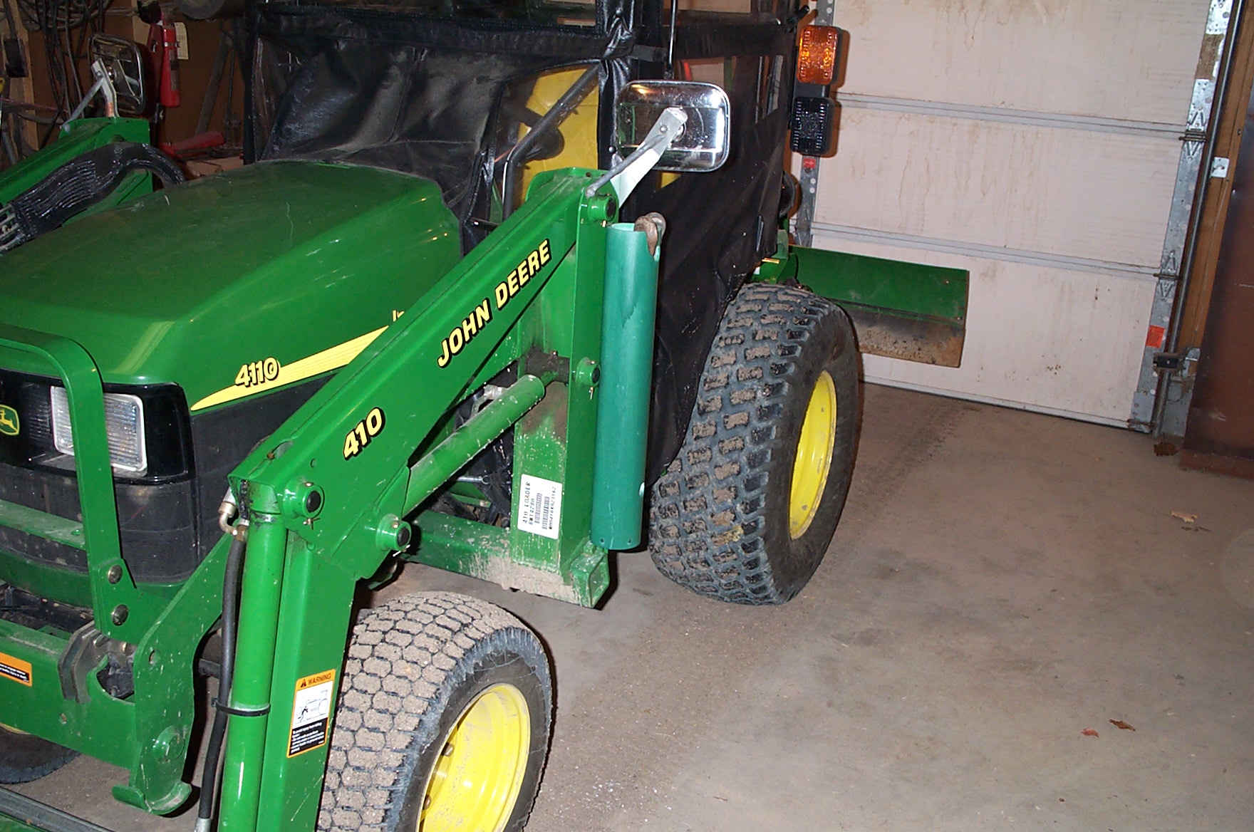

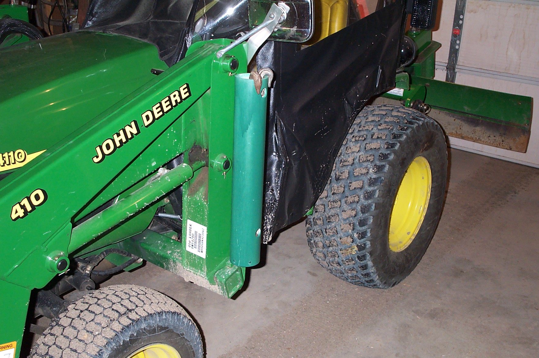

I recommend a piece of PVC pipe attached to the loader vertical frame. Use a cap on the bottom with some drain holes drilled in it, or cut some thick plywood to cap it.
The chain(s) fall right inside and the hooks hook on the top lip.Even takes paint.Maybe like mine there are some avail holes predrilled to bolt it on with

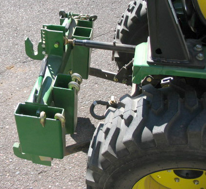

Running a quick-hitch/I-match style? If so its a good place to add up to 4 boxes---see pic. Good luck.

Now thats a good idea. I had a quick hitch but sold it with my other tractor. I now have the expandable lower links which I think work much better. They seem to be less effort to connect to my implements. I guess I could but a chain box on all of them.

Built one today! Works great! Thanks for the idea.

dj1701,If you could do a picture I would appreciate it ,I have been trying to find where you set your pipe and what diamater/ length.What a great Idea

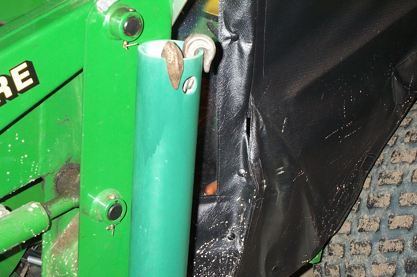

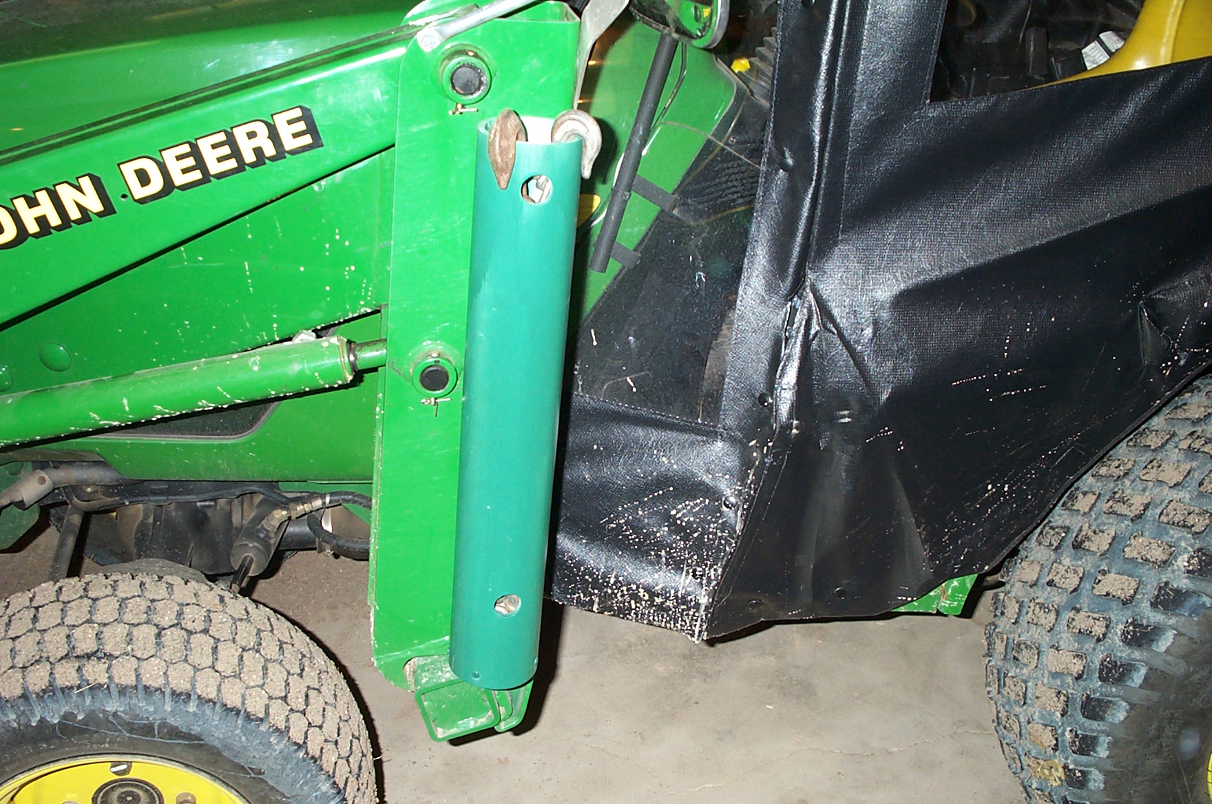

Here is another variation similar to Pipestone's.
4" pc of PVC cut in half, hose clamped to the loader uprights. My chain bucket wasn't big enuff to hold both chains so I made this setup. The hooks hang on a pc of 2x3" sq tube that is bolted to the upright (and yes the holes were already there). The smaller pc of pvc holds pry bars, long handled monkey wrench, and whatever else won't fit in my toolbox.

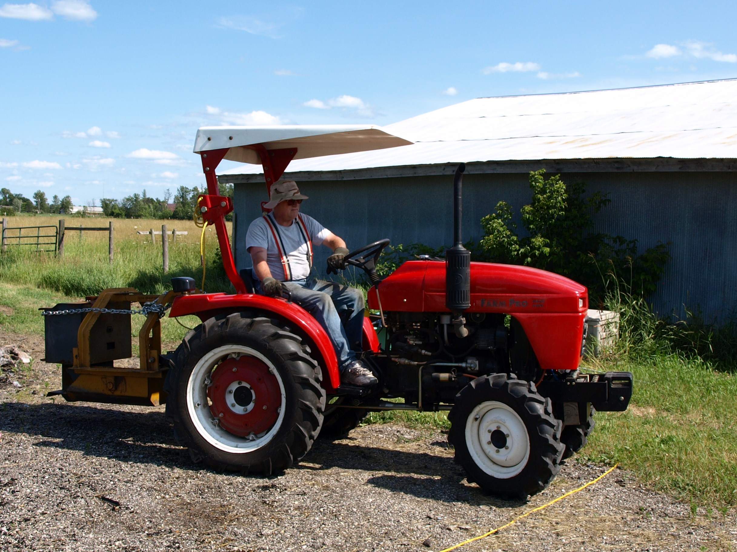

Your chain "bucket" is very similar to mine. My design is "pinned" in so I can pull out a pin and pull the entire chain bucket out.
