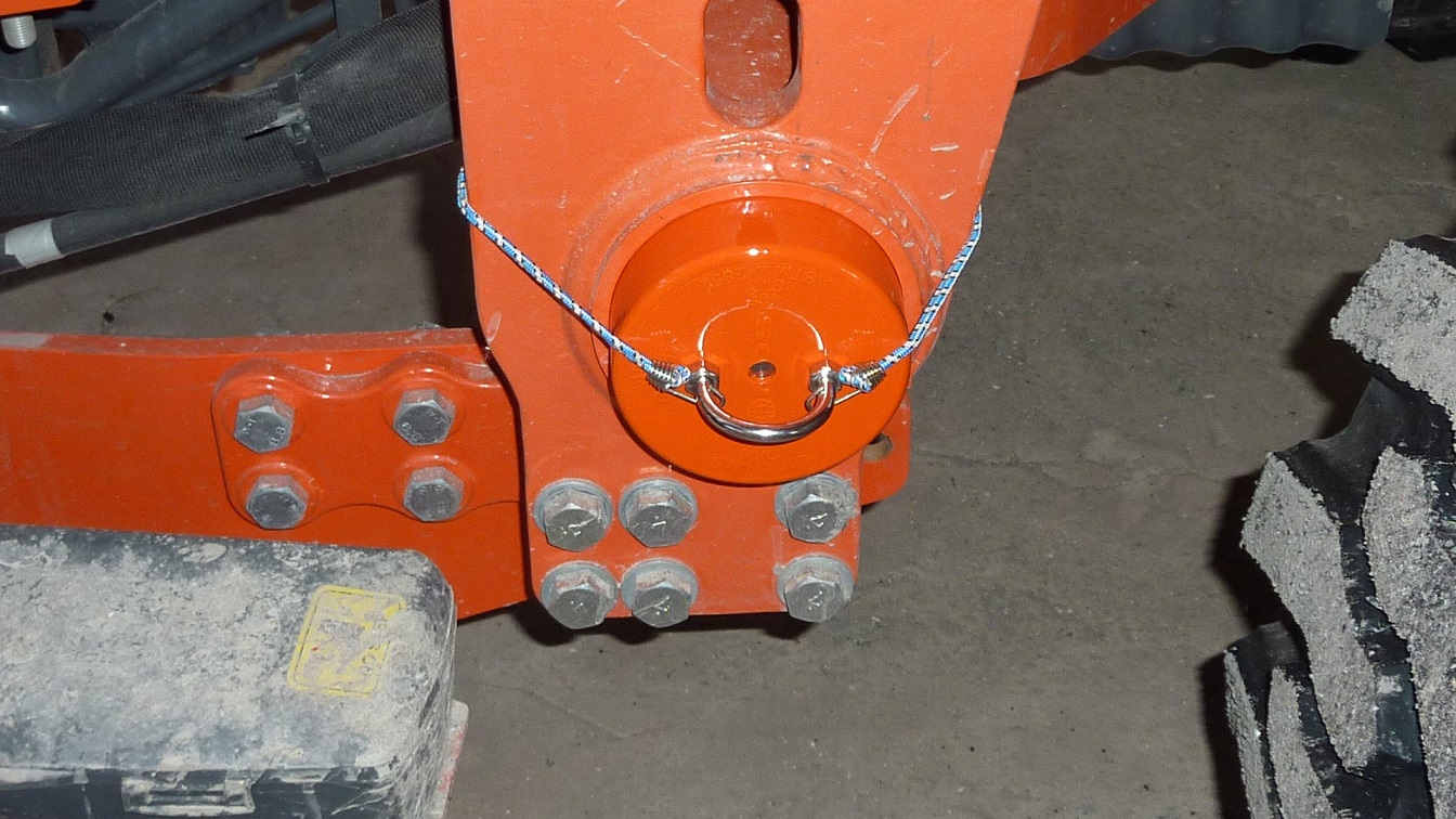

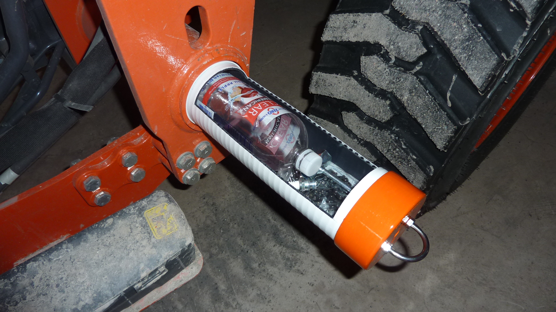

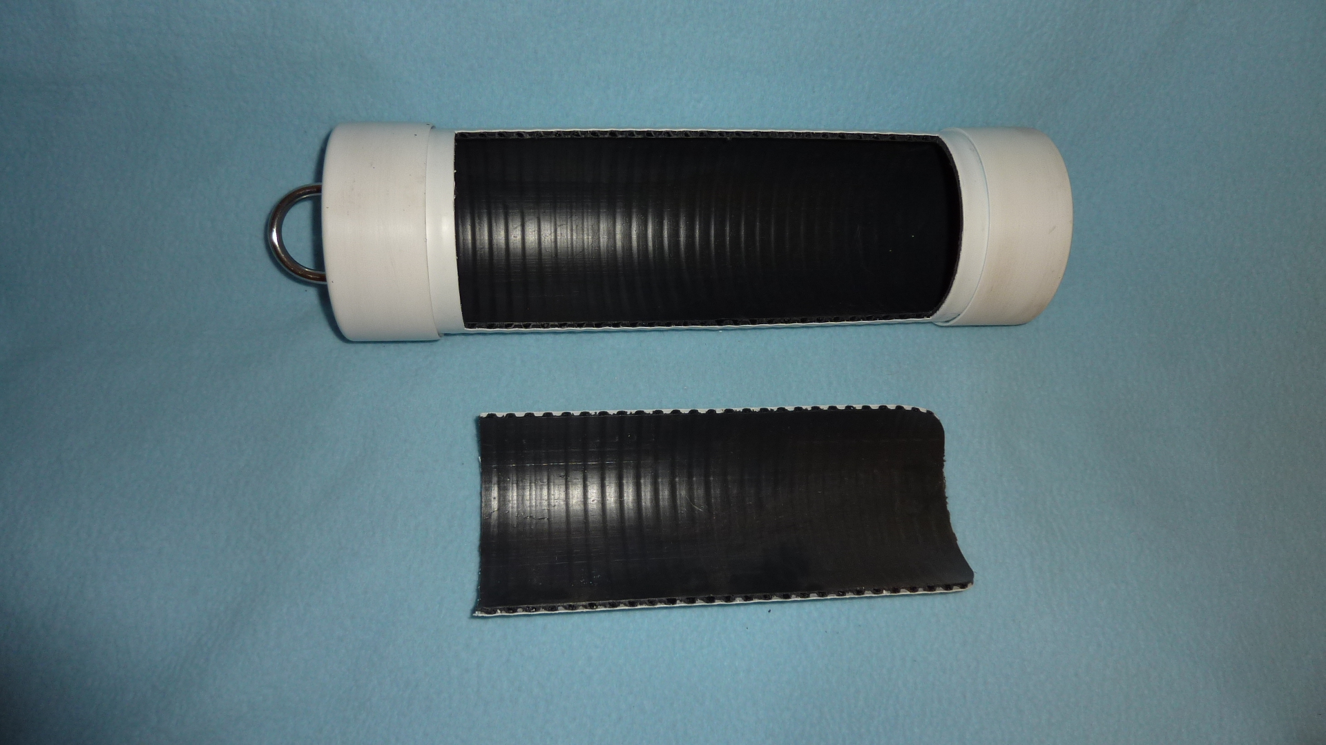

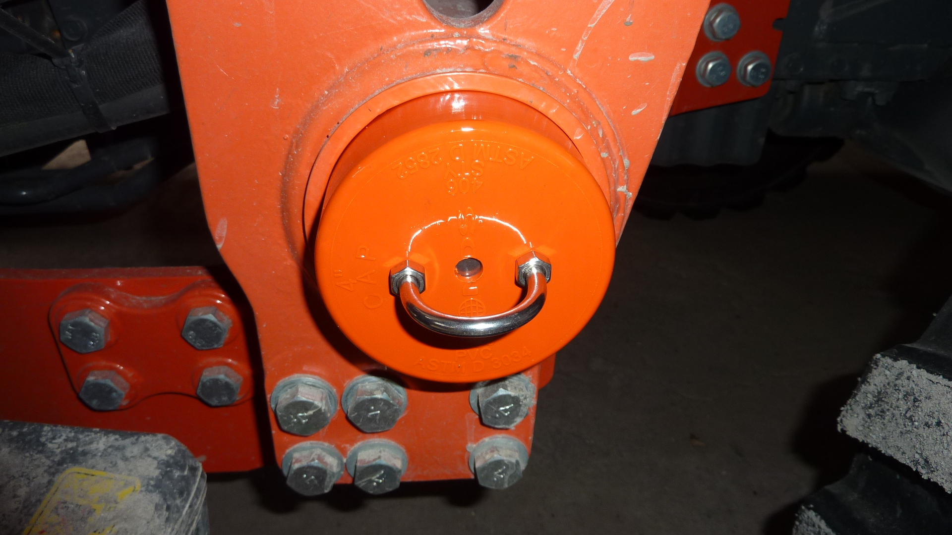

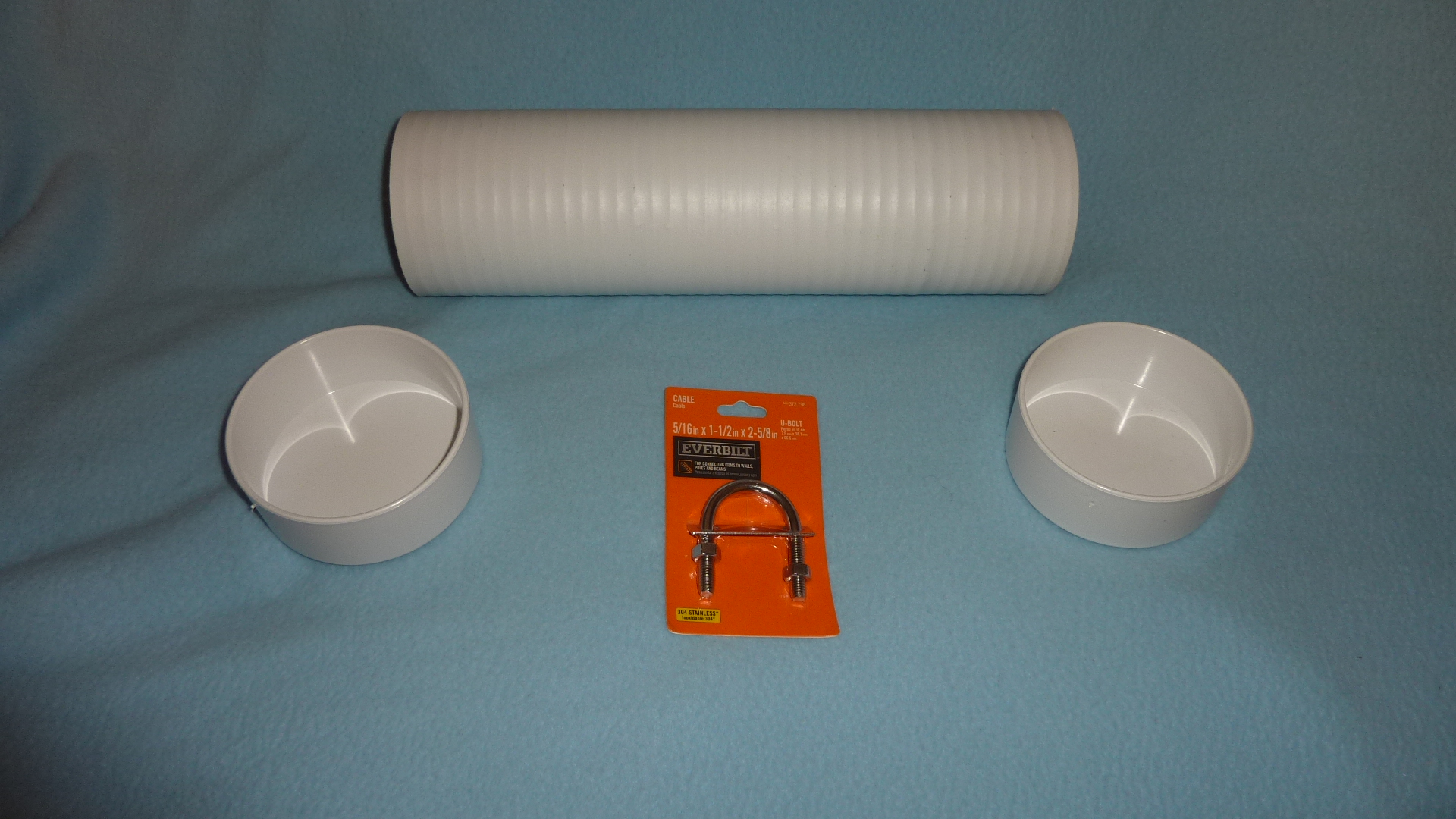

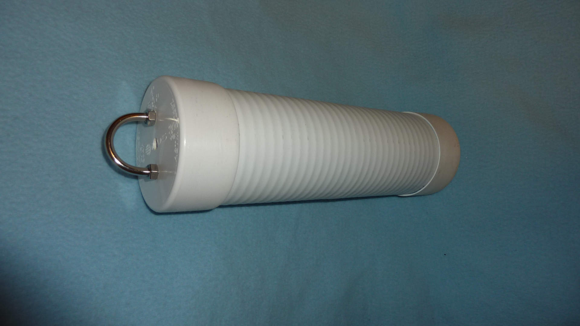

I use a similar scheme on my Kubota tractors but I use the FEL frame cross tube under the machine. With a little sanding, Sch 20 PVC pipe caps are a jamb fit in the tube. Not sure if this would be true on the Massey.
I use them on both sides of the tractor. Each compartment can carry 10' of 5/16" chain with room to spare. I've never had one open by itself but a small bungee is a good precaution.
Took 20 minutes to build and cost around $5 each excluding paint.

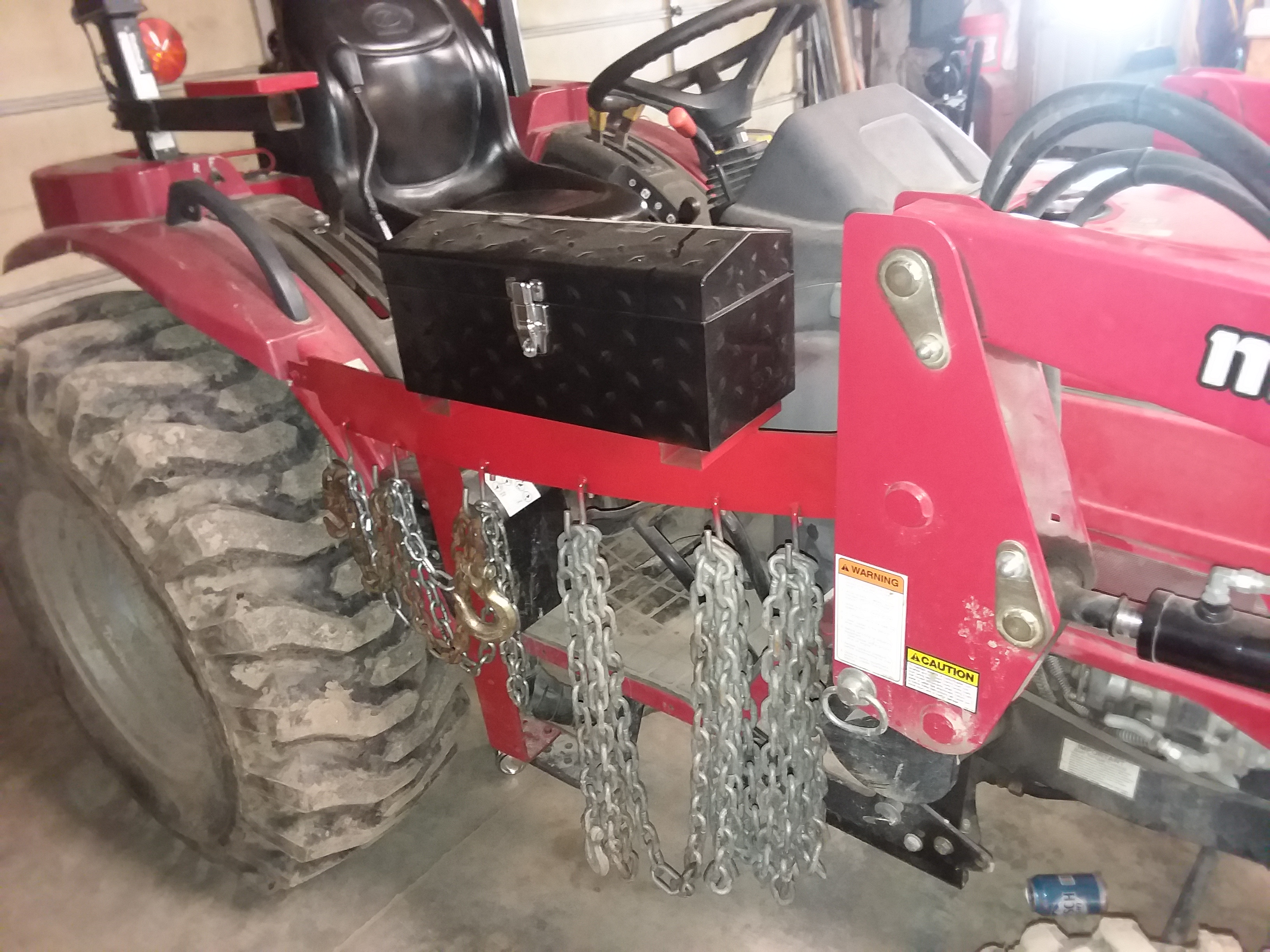

20180410_174100.jpg Since I cant get on or off of the right side of my tractor, I added this chain storage and toolbox mod. It is bolted through the step, and bolted to the fixed part of the loader frame. I also have it bolted through the metal portion of the rear fender with a large rubber bushing. The large s-hooks are welded to prevent too much swinging of the chains. And the toolbox really needed a good place to go too. Everything lives well inside the wheel path.
