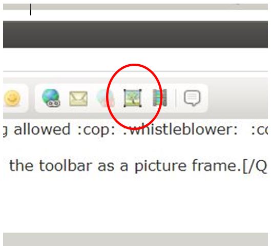

The forum allows pictures. With me that option is in the toolbar as a picture frame.
   / Chain storage
I'm not finding any option to add pictures, if somebody can help me out I will post them. I tried a search I did not see anything and could not find any kind of a help menu. So I'm stumped.
   / Chain storage #4

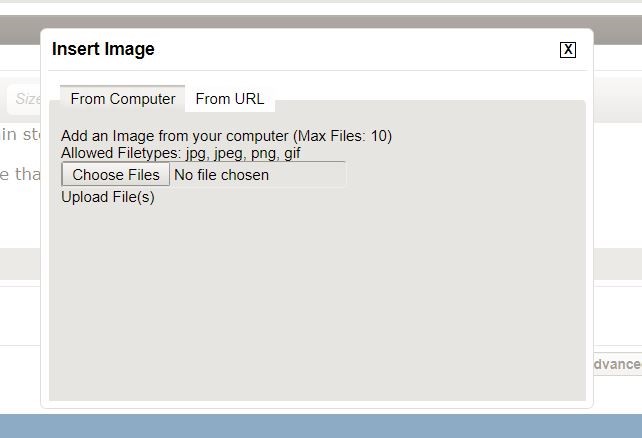

Here is the icon you press to start the share.
This is where you chose your photo from your computer or insert the URL. Now, let's see dem pix.

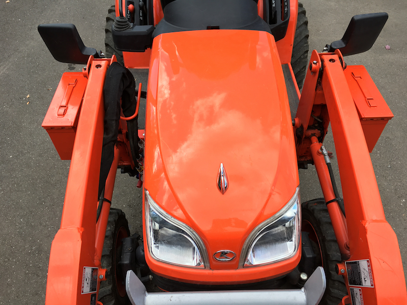

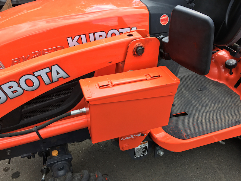

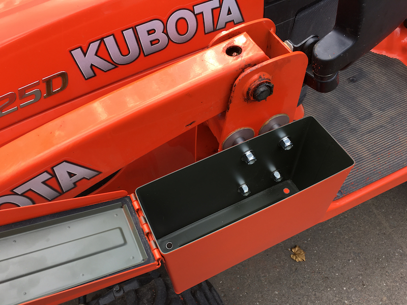

Well here is my chain storage tease... w/pics!

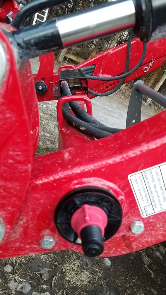

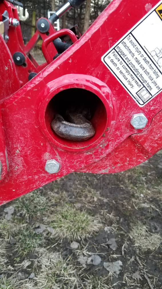

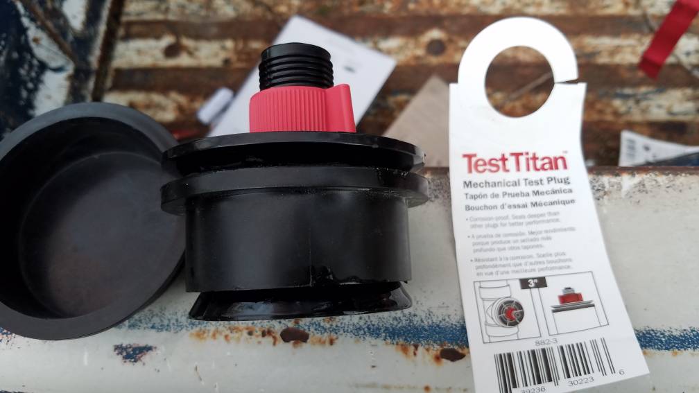

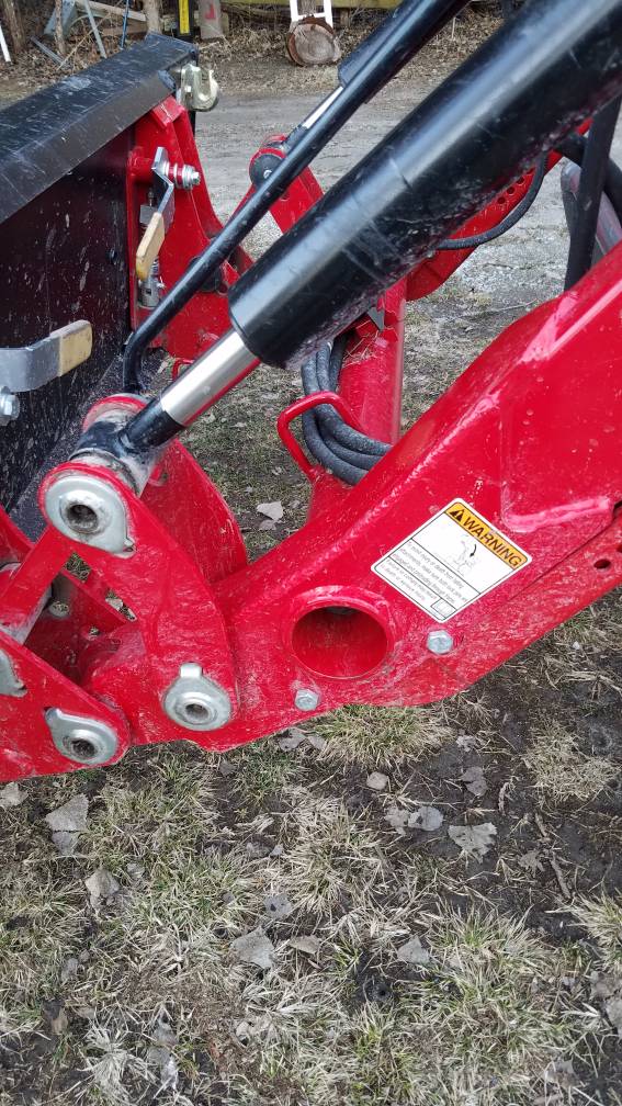

I came up with a great chain storage solution today, was going to post pictures but don't see an option to do so.
Now with pictures!
So first I pulled out the plastic cap plugs that were on the ends of the tubes, and then I put the chain in my crossbar tube that runs between the loader arms behind the bucket and then put a plumbing expansion plug in each end and it has clean secured dry storage for the chain.20180327_192149.jpg20180327_192155.jpg20180327_192437.jpg20180327_192934.jpg
