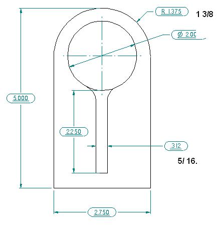

Where can I find a Grab ring for 5/16 chain.:confused2:
A grab ring mounts on the clevis of my draw bar Looks like two circles joined.
One big one that mounts to the clevis and one smaller one that allows me to slide up on the chain and grab the link where I want.

Chain saddle grab link..

Why don't you just make one
here is the measurements for one with 5.16 chain and 2 inch attachment hole.
/ Chain stuff #14
Forgot to say that one should use 3/8 plate.
Start with a bit of 5 by 2 3/4 flat.
Make the 2 inch hole.
Drill the 5/16 hole 2 inches from the 2 inch hole and cut with a metal saw.
