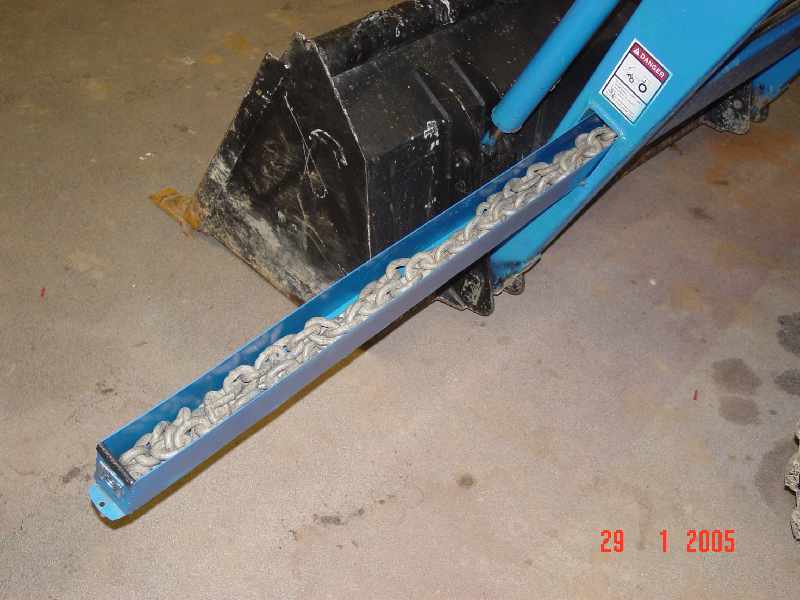

Here is an Idea I had to keep a chain with me at all times, All you N.H. 7308 F.E.L. guys out their got to get you one of these! It was easy to make and you never have to worry about your chain catching on something. I've been using mine several months now and It works great. /forums/images/graemlins/grin.gif

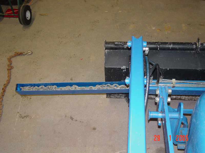

Here is another view!

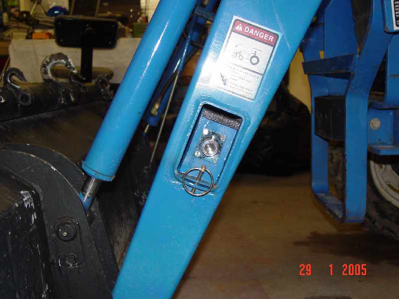

   / Chain tray
Here it is all snuggled away!

Very ingenious ! Nice project. Thanks for sharing. I have the 16LA FEL and can't remember if I have an open space like that or not. I will have to check when I get home.

Quick! Apply for a patent. Somebody will steal your idea, and soon you'll see them for sale on ebay. /forums/images/graemlins/shocked.gif /forums/images/graemlins/mad.gif
That's one darn nice job. Even the pull-ring is well thought out. /forums/images/graemlins/cool.gif
GATC35: None of the curved arm loaders have an open crossbrace. We can't do what Mansker did. /forums/images/graemlins/frown.gif

What a slick idea!! I just love this site. Just wondering out loud, but seems like that would be a really great idea to employ a version of that on a box blade. I seem to always have the BB on the back of my TC40 as counterweight and I keep a couple chains kind of draped over it and they are always a pain to take off, or put on, Seems a little "drawer nestled in some thin wall 2x3 rectangle tubing would make it slick and add a touch of weight in the right place (I know 15#'s won't make a bit off difference, but it is an excuse /forums/images/graemlins/grin.gif)

I would go with at least a 4"x 4" tube. You won't get much chain in anything smaller. my tray is 2 3/4"x5" and it is full with a 18' chain.
