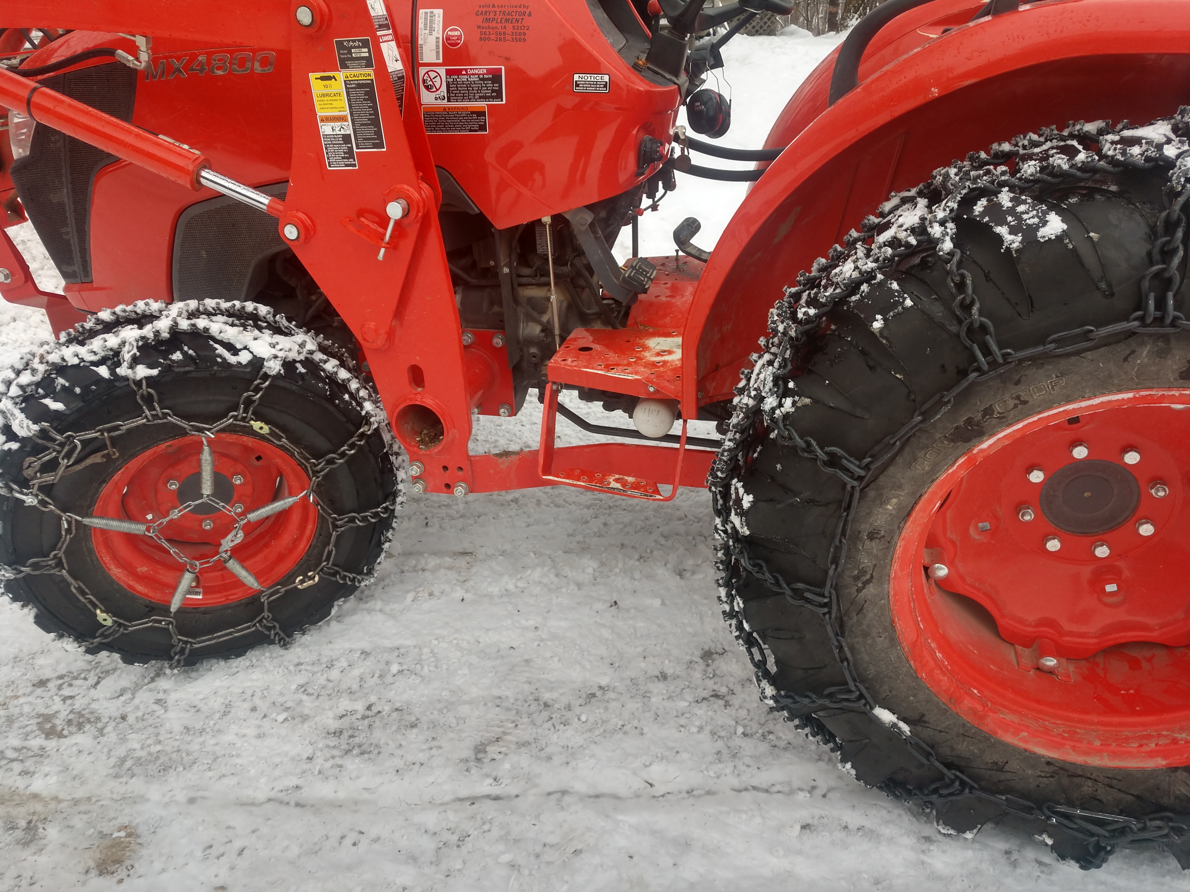

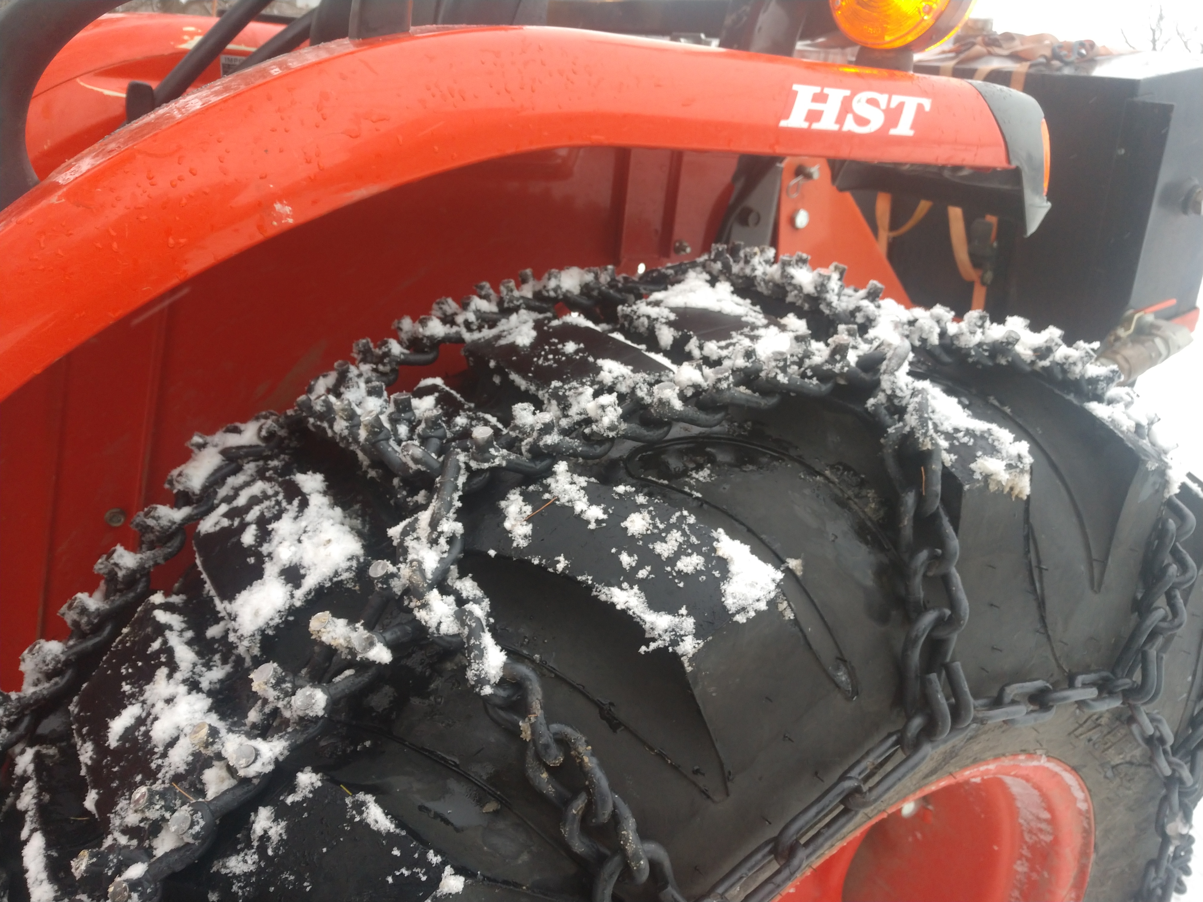

Chains came in today. The went on quite easily.... after I figured out the split link LOL. That being said, they are a full section long. Others have said the same thing. Too long is better than too short! They worked great... traction out of this world!!! I was told that chain tensioners are not required. I ordered them anyway... they came in on UPS after I put the tractor was put away.
   / Chains and Tire sizes #13
Looks good, I know that I can run in 2wd much of the time with the rear chained.
The traction is equal to dry ground.
View attachment 639524View attachment 639526
Very nice!!!
You don't need tensioners on the rear chains because they are properly installed. You definitely need tensioners on the front chains because they are not. :)
I can't imagine how you could ever need more traction than you have now!!!
