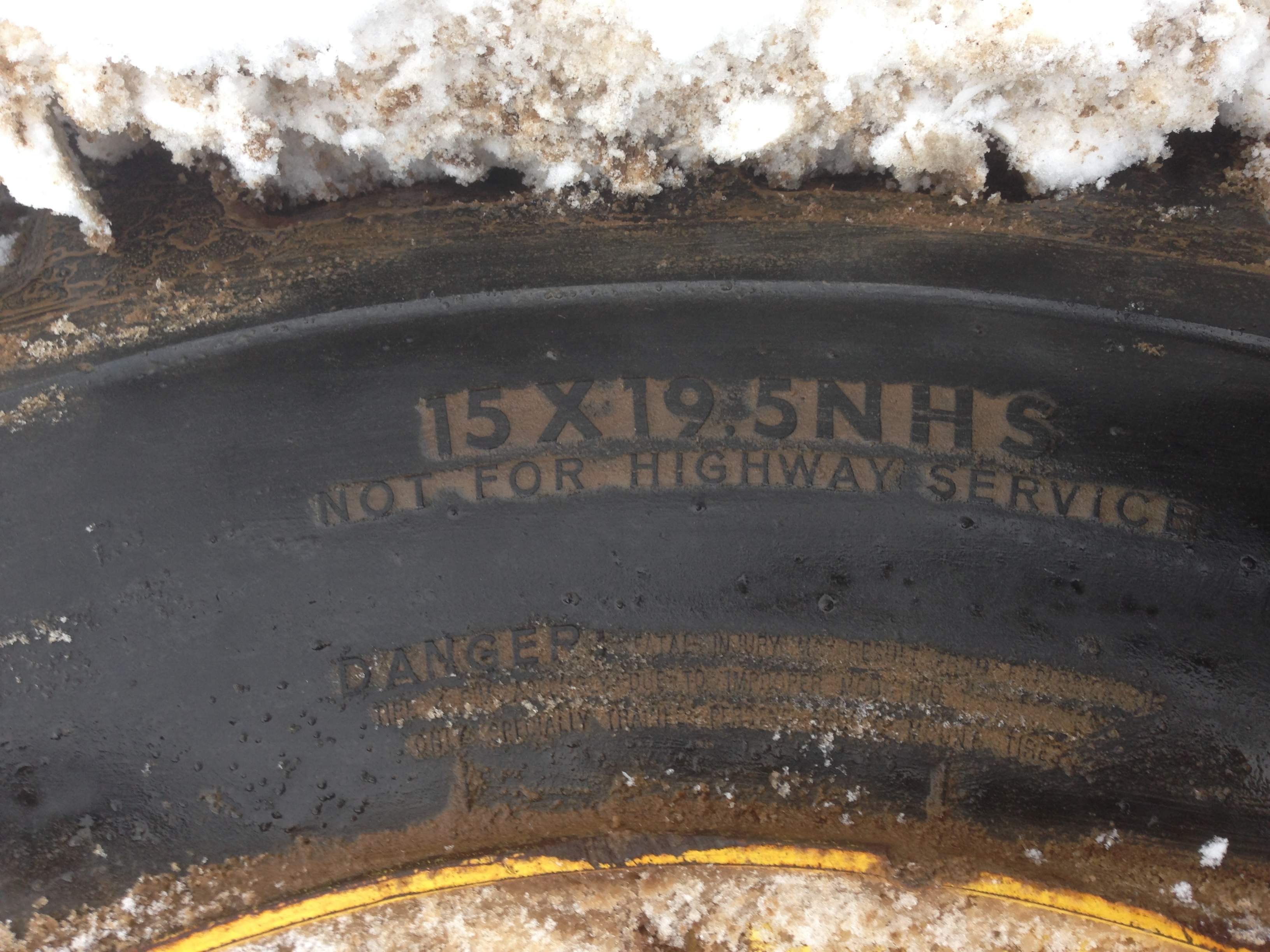

I can't seem to find a set of chains for these guys, anyone know what set will fit? I am probably just not looking properly.
I am looking for the chains that ride on top of the lugs for max traction. Any ideas or pointers would be appreciated.
