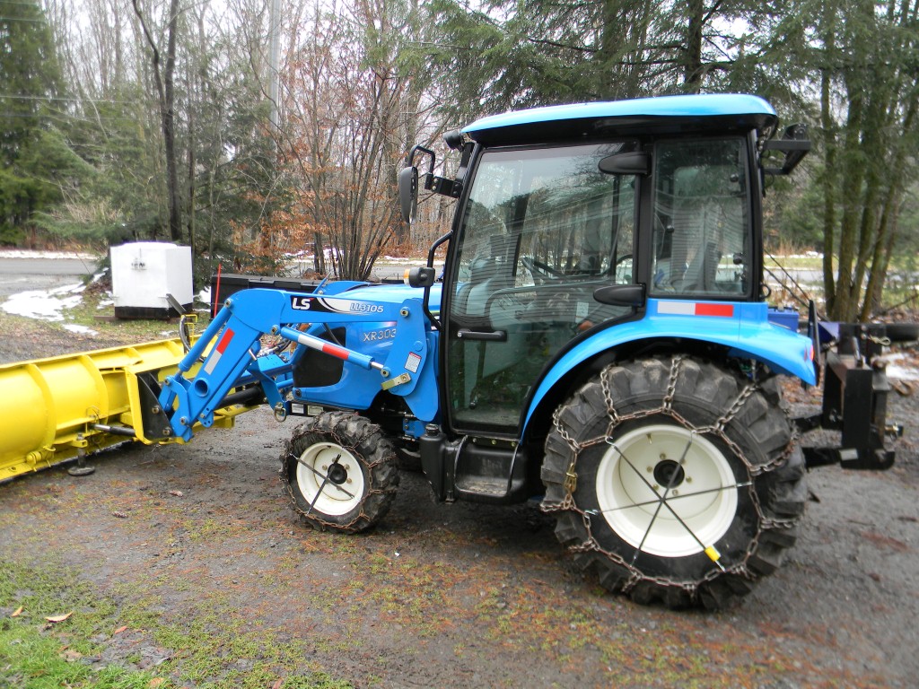

Interesting, I'll give a good report on how well they work. Possibly have them mid next week, but by then it'll be 60 degrees and sunny. ;-)

I have them on my fronts. I use V-bars cross links on those for better steering.
I'll probably order the same, I like the idea of super traction.

Thanks everyone!
I've wanted chains for a while, but didn't know about tirechain.com being such a good resource / place to buy.
In addition to the rears, I picked up v-bars for the fronts just now as well.
~Moses
