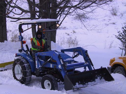

I have a 224 with turfs and chains. The chains are for a truck/bus tire size 9.00 x 20 tire or 10.00R 22.5 (basically the same size tire). I got mine for free from a buddy. They work pretty good and I have no complaints. I do have my rears a installed to the wider size just by swapping the wheels. I used it all winter and had no clearance problems as long as you make sure chains are tight right from the start.
I'm sure you can just type in a search for tire chains and come up with many web sites that sell them. They do not work well on Ag tires as the chains sit low in the lugs and make little advantage.
Take a ruler and measure the circumference of a tire and get approximate width and give them a call.
Here is a pic of my chains.

thank-you Harry,I was mostly concerned with the chains hitting the fenders and it sounds like you haven't had any problems with that..I'll go ahead and try to get some bought...thank's again!!!

are your fenders metal - or fiberglass - or plastic ?

Hi Greg...they are fiberglass..held up good so far (100hrs)

Ok. Your business then, but I personally wouldn't even consider chains for anything but metal fenders

Mine are fiberglass and I measured 3 1/2" clearance between tire and fender. I got mine tight to begin with and did not have any problems period. They are great when its icy BTW. End of story.

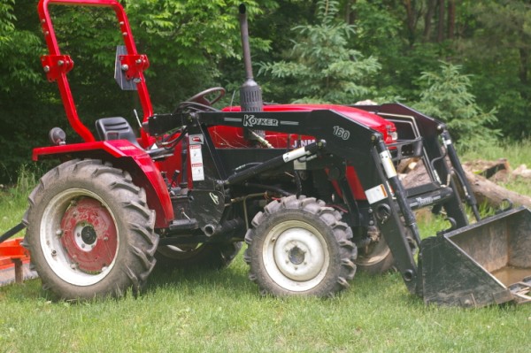

How many hours do you have on your tractor Harry? I've got about 230 on mine and except for the earlier problems around that deaded 50 hr mark, it's running great..Take care...
