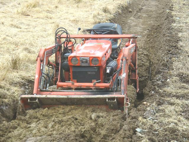

Mud and chains on a Kubota B7100.:D

Thanks to all for the advice. Chains it is. Now about the wet spots. There are a few areas that can't be drained so I'm thinking of putting down 1 1/2 to 2 inch black rock to bring up the trail bed. Any thoughts on that one.
You might try that in the bottom of the wettest part but would want to top it with something that can compact at least a little, or it will always be loose. If you have any native fill on your property that has some gravel in it you could dump that in there.
If you had to buy material then IMO a large process mix would be best. That's like the first material put under a road or what they make temporary driveways at construction sites with. sometimes just 4-6 inches will stabilize a bad spot, especially if your just driving small vehicles over it.
JB.

Agree on the topping. If you have native rock laying around, even as big as 18", that would make a great base to build up the mixed sizes on. In Vermont, you must have a few rocks looking for a new home :) They might eventually heave up towards the surface a bit from frost over 5-10 years, but I don't think they would become obstacles. Water will actually drain through/across a bed of larger rocks.

+1 on the bigger rocks. I have a couple of areas that I filled with rocks ,then gravel. Makes a 'french drain" that even when wet can be driven across without sinking up to the belly :eek::eek:.

Depending how deep wet area is...
I agree w/stones,something in the lines of river wash gravel mix w/stones.
If you can dig some of the wet soil out,dump gravel/stone than pack,put extra gravel/stones on wet area in time in time gravel/stones well settle.

I agree with your thinking on the 1 1/2 stone, Like someone else said if its possible dig out the poor material if you can, If not use 1 1/2 if the hole is less then a foot deep otherwise the hole will continue to " pump" and stay mushy know matter how much 1 1/2 you throw at it , if you have a bigger hole then mentioned find the biggest rocks you can move and start packing them in, then top with item4 or shoulder stone , my industry has a bunch of different names for it , its generally 1" minus and the first thing we take out when screening crushed stone , it does not always work in wet areas , do to the dirt and fine material content !
