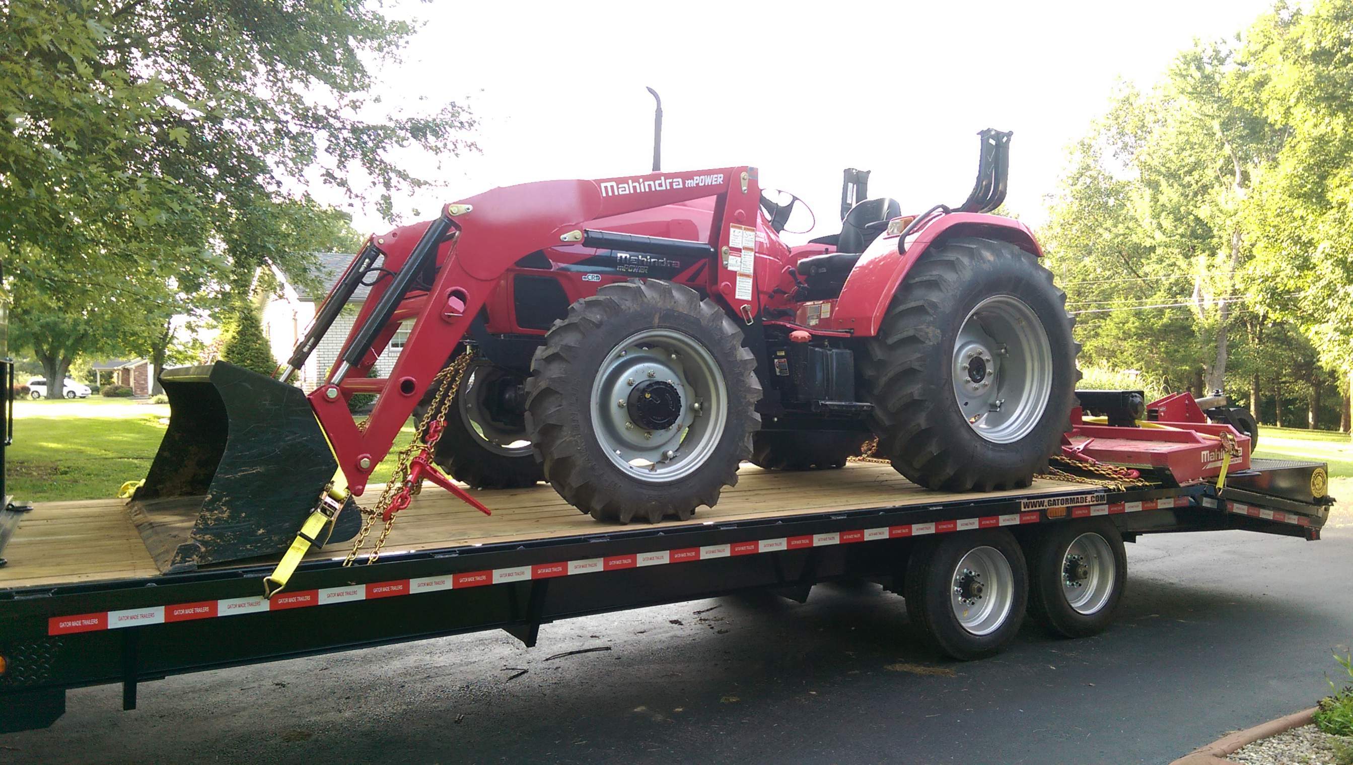

Nice Trailer!
I don't like those style of straps but prefer the more rare ones with a length of chain and grab hook on the end. They loop nicely down and up through a pocket.
Funny how picky the authorities are about chain and straps but have no concern about what the chain is attached to.
Nice trailer AND nice truck.

Thanks everyone...very happy with both so far...first gooseneck trailer and first diesel truck.

I'm about to purchase a tractor that's going to weigh between 10k-12k... My biggest fear is making sure I get this tied down properly. My farm is about 60 miles from my house... Plan on making this trip about 8-12 times a year hauling the tractor.
Anyone have some advice they'd like to share, examples of what not to do? Pics would be great.
It will have loader and cutter... I'm guessing I can get away with 4 chains and a couple-few straps?
I'm sure I'll overdo it the first few times, but would love to hear where I can buy the best chains and binders.
Does Harbor Freight offer ones that are reliable?
Home Depot or Lowe's?
Should I look at places that sell trailers? Tractor dealers sell them?
Appreciate any and all advice.
The tractor will be delivered soon and I'm hoping I can see how it was tied down upon delivery and take pictures and learn from that as well.
Thanks
Four chains
Two load binders
All suited to the load (X3)
Make sure your attach points are worthy of the task!
