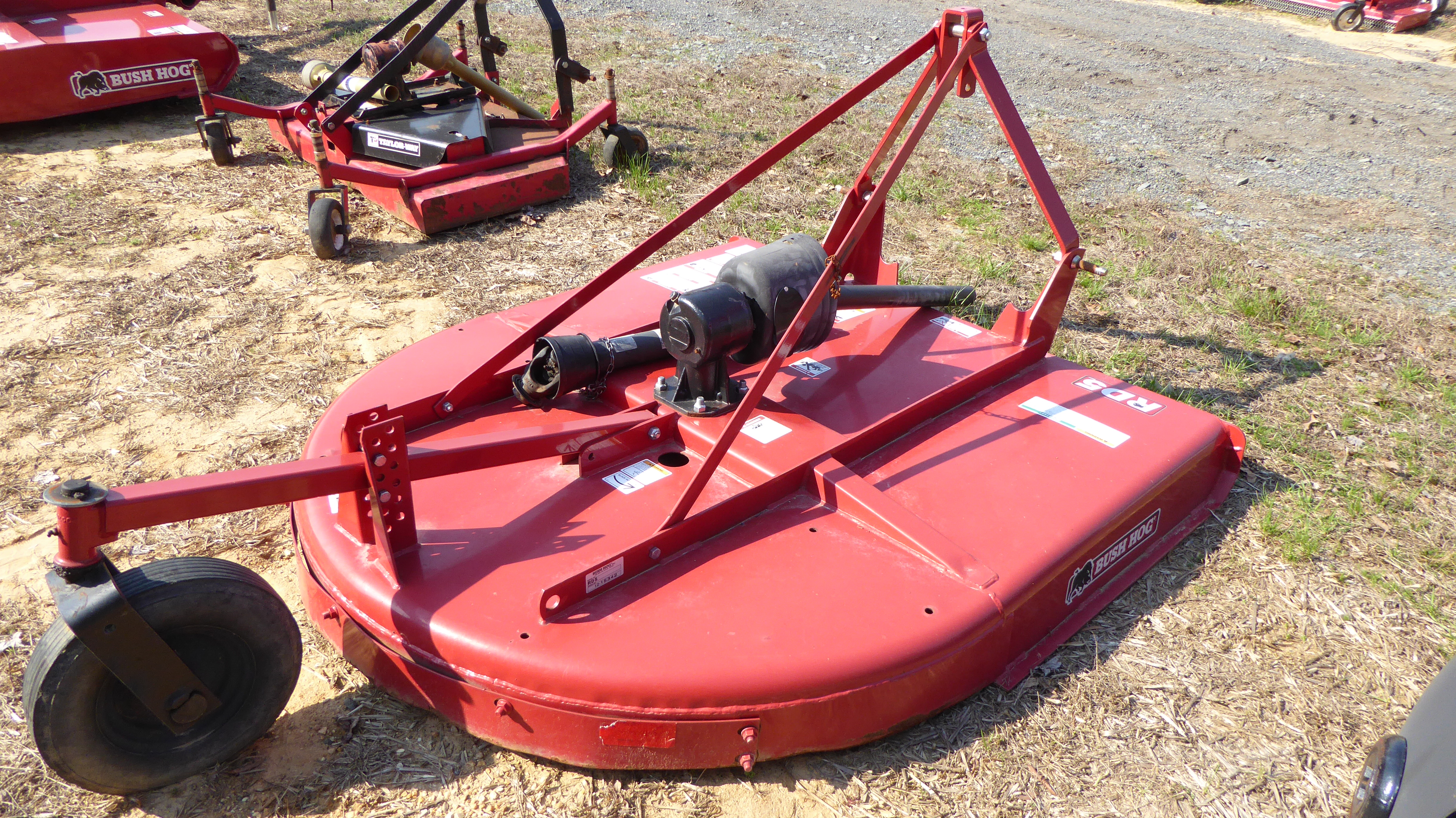

LouNY, ruffdog is is just saying that he is running the pullbehind hitched to his 3pt such that he can raise the front of the hog when needed (I think, putting words in his mouth.) Since ruffdog posted a link to his KingKutter purchase I'll post this:
I got this for $1000 from my local dealer who took it essentially unused on a trade-in. Notice it has the manufacturers 'loose clevis' providing some flexibility in up-and-down but not like a chain does. This Bush Hog brand unit has a 50hp gearbox. I use it mainly on one of my 24hp Kubota's.
