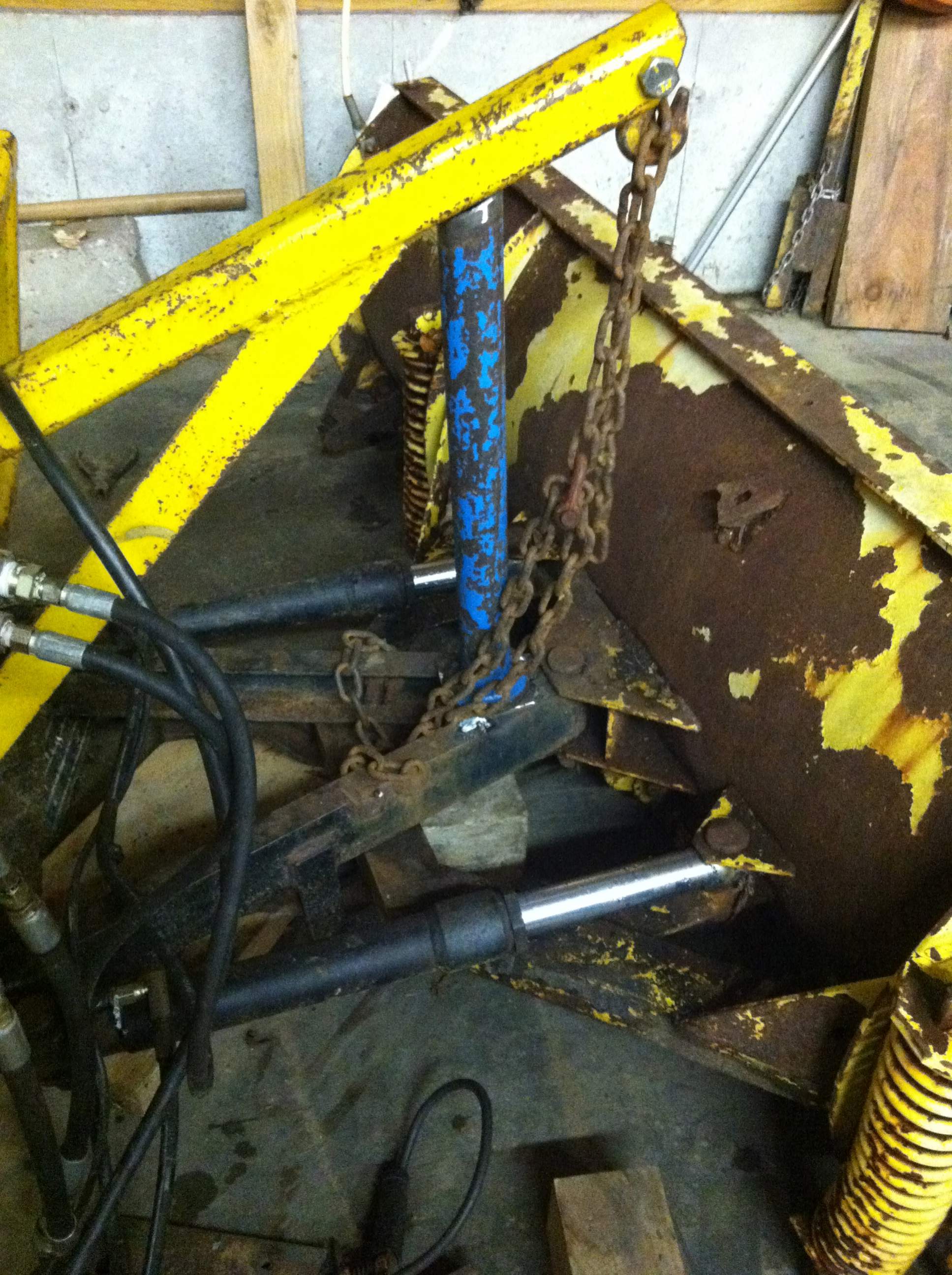

Well guys we had a total of 15" of the slickest snow you can imagine here in Central Mass last two days. I have R-4's, loaded tires and a 550 pd weight block but I spent lot of time spinning my wheels on this stuff. I'm pushing a 6.5' Fisher plow. IMG_1921.jpg
Anyone have any experience with chains on front axle?
Attached shot is of my plow set up- older blade, not the "new" junk yard fisher I have now

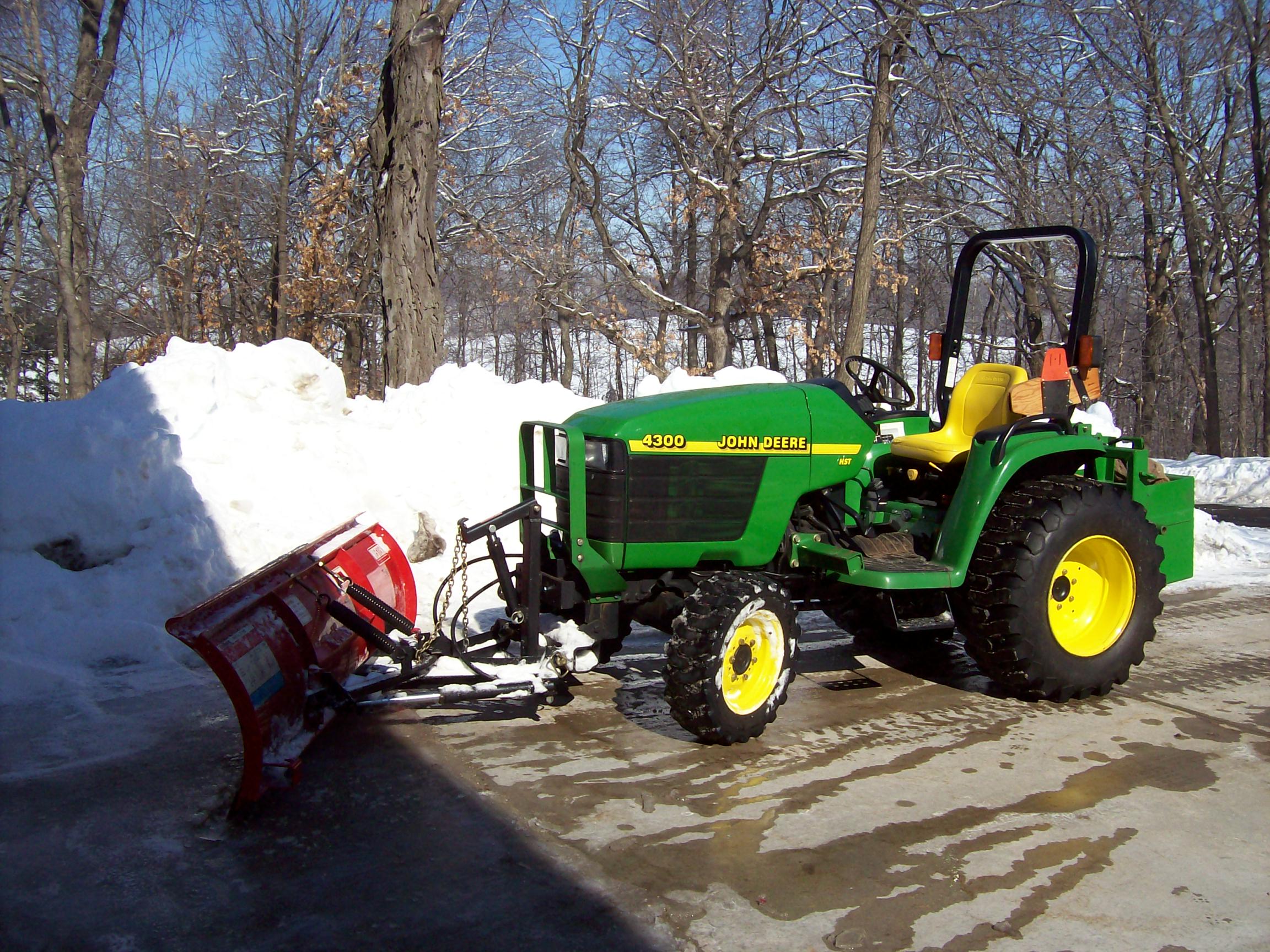

Have a JD 4300 with a 7' plow, and often run with chains on the front wheels. Not on in this pic of the plow.

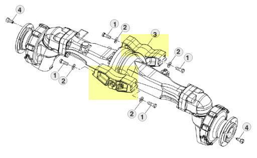

The 4720 has front and rear trunnion supports on the front axle just like most all 4WD tractors. So whether pushing or pulling it has the same support. I would also be willing to bet that more force is applied to the front axle when using 4WD for things like plowing or pulling heavy objects than ever would be applied in slippery conditions using tire chains. Just imagine the forces involved when using 4WD during the summer to aid in pulling out a stump or pulling your neighbor's pickup truck out of the ditch.
As anyone who uses tire chains in the winter knows, they do NOT lock your tires to the ground and only serve to provide slightly better traction than would bare tires. In other words, chained tires spin plenty easy in snow and ice. :)

and one more thing, my 4720 is a 2007. Any chance the '07's were built without a zerks on the trunions? or I'm blind.:)
/ Chains on 4720 front axle #19
I've been looking over the Owner's Manuals and parts illustrations and it appears there are no grease zerks on the front axle trunnion. When I made the comment about greasing the front axle I just assumed it had grease zerks. But apparently it does not. There are no zerks shown on any of the parts diagrams for the front trunnions on the 3x20 or 4x20. Lubricating the front trunnion is also not listed on the maintenance schedule - only tightening the thrust bolt. Now, it's possible there are zerks but they aren't mentioned in the manual. It wouldn't be the first time that has happened. I can't imagine those trunnion bushings not requiring lubrication.
Oddly, on the newer 30xxR and 40xxR tractors the construction of the trunnion looks identical except it clearly shows a grease zerk on the front and back of the trunnion and greasing the trunnion is illustrated in the Operator's Manual.
