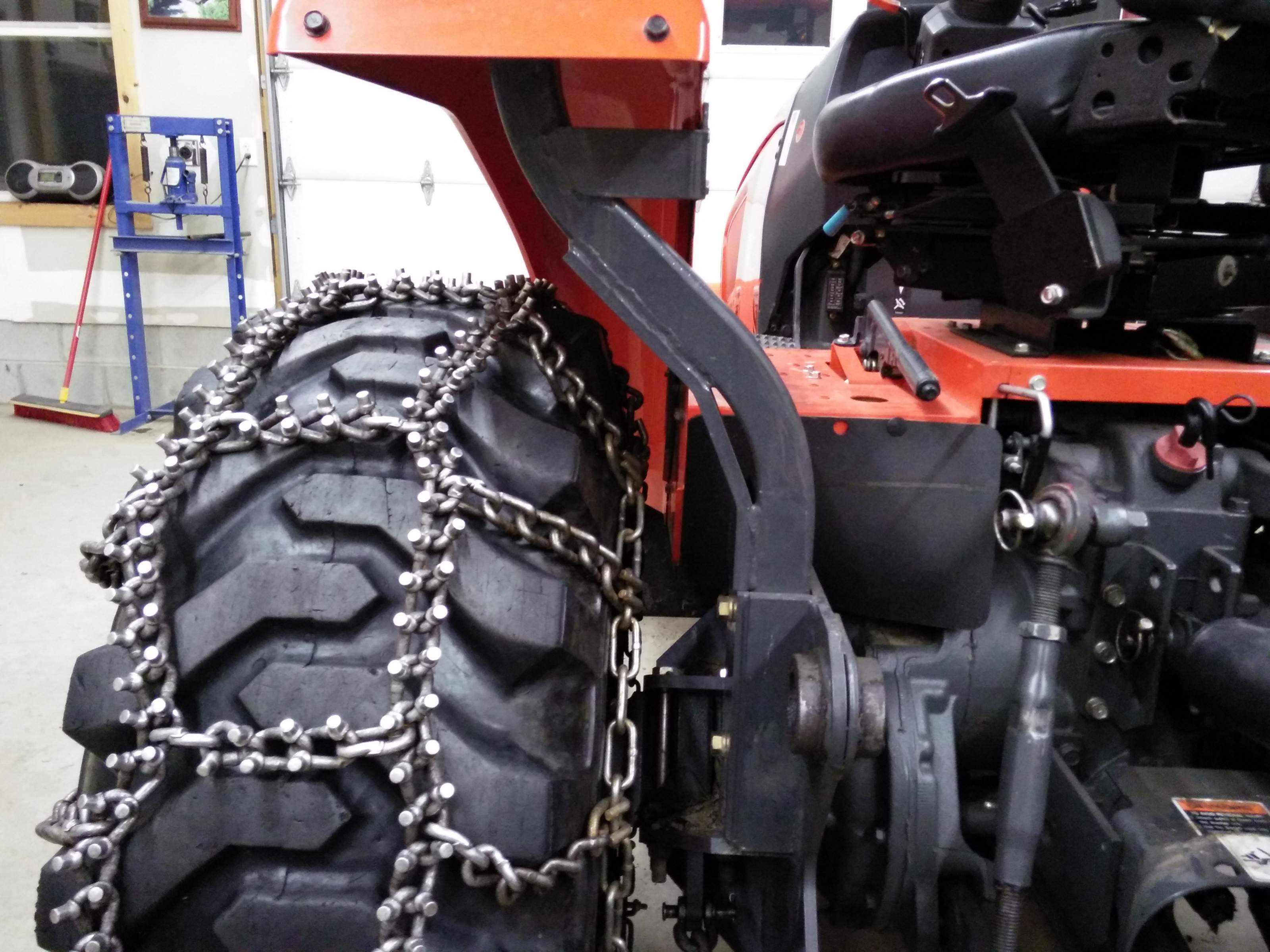

Anyone running chains on the rear of an l45? I just want to confirm they will clear before hitting the submit button on the order.

Based on my B3030, I would think that if you have more than 2" of clearance between the tires and frame/fender--go for it.

Tirechain.com said 2 3/4" required...and it's definitely CLOSE.

I have Tellefsdal chains on my L45 and have about 1-1/4" of space betwwen the chain and the fender.
Those look like they fit pretty easily.
They sure look ANGRY. I assume you don't use them on pavement?

They do go on easily, and yes they are "angry" (lol). They offer great traction and ride smooth too. I dont use them on black top. My driveway is gravel and quite steep. I had regular cross chains at first and they didnt work well at all. They had to much gap between the chain so the traction for going forward as well as slowing down on the hill was terrible.

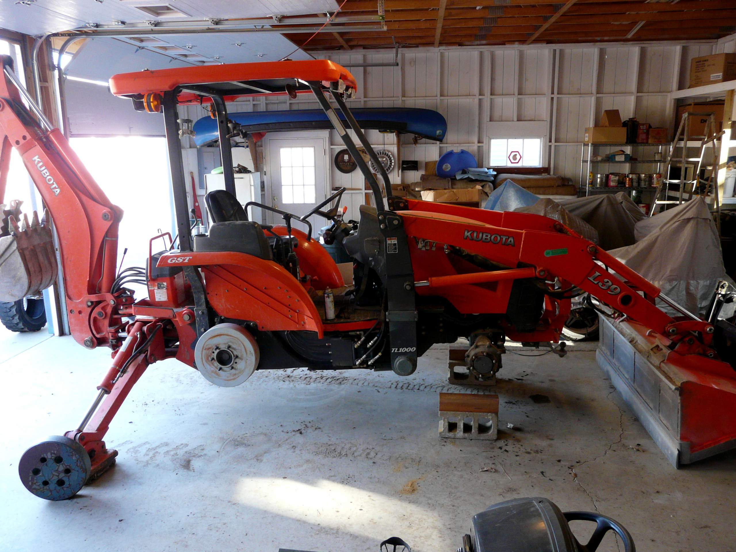

I use custom inside wheel weights with 1" Spacing. Tires are way to close to fenders otherwise.
