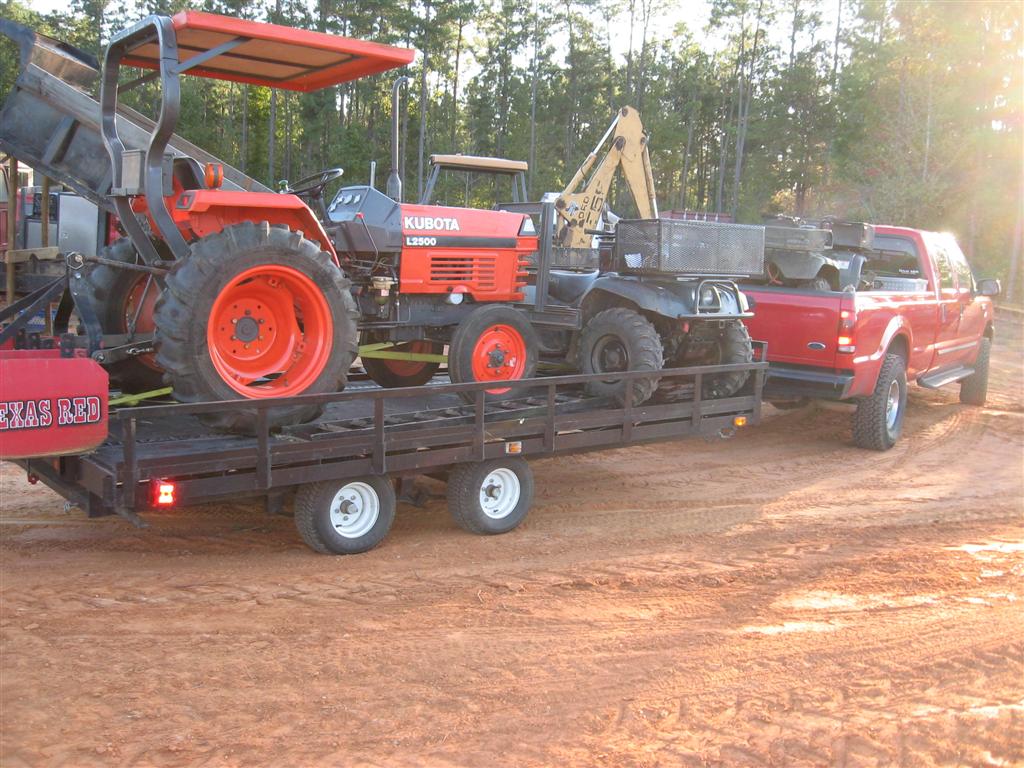

I use straps, easier to store, easier to work with. I only use 2, one pulling the front to the back of the trailer, and the other on the back pulling to the front of the trailer. My L still has a really strong parking brake, I also put it gear. If I have an implement I lower it all the way down.
I drive much slower when towing and watch out for that other guy.
Here is my tow from last Saturday up to Eddie's place. You can see the straps. Actually I think I moved the tractor back a bit as I was about to unload the ATV.

You setup yours exactly as I do mine except straps vs. chains. If I decide to go to straps, suggest a good place to get them? TSC?
