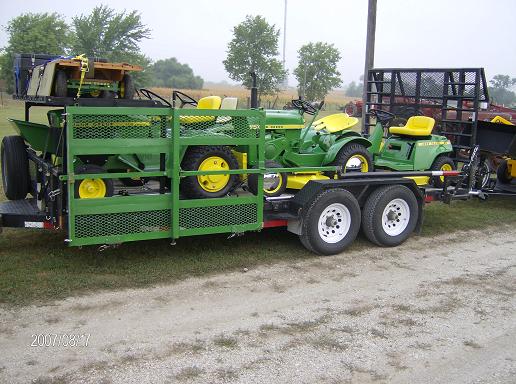

You might want to check your state regulations, some states require FOUR CHAINS on tractors (assuming the big stuff). Personally I use chains on my farm tractors 5000 lb. - 8000 lb. For the Mule & garden tractors, straps are ok, although on the Mule I do use a loose "saftey hook" since I have brooken one strap in the past. As for the time it takes, it takes me 1 1/2 hr to load & and strap a 16' trailer load of garden tractors (or unload). Two dozen straps or more!
