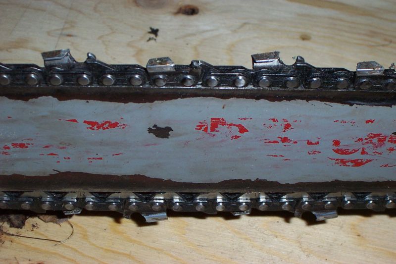

I'm attaching a picture of my chainsaw chain. Would you folks give me a Chainsaw Chain 101 Class ?? I've read threads on here about different style chains & different angles. I cut about a 50/50 mix of hardwood & softwood & sizes from 1" to 12". I also was told by someone about cutting the stub on the leading edge so the chain takes a better bite. I'd appreciate any tips on the chain/bar & even any saw tips. My saw is a Partner Pioneer 5000 about 15 years old but very little hours.

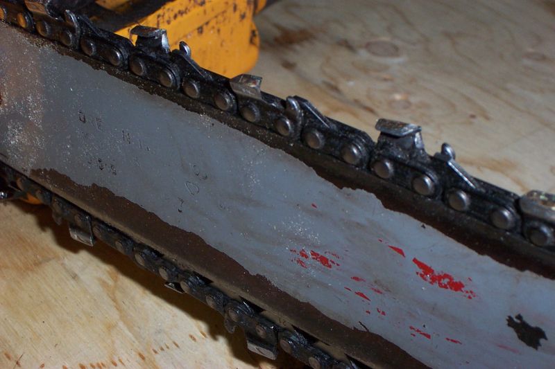

Another picture of the Chain. When I file the chain with my 5/32" round file, all I do is follow the existing angle. Any tips as to how to file the chain "properly".

good guy, they make a filling guide, that's simply a U shaped peice of steel, about 6-8" long. it sits over the chain and shows you the angle to file at, and it also has relifs that show you how much your rakers are worn.( the little bump infront of the tooth)
you don't want to file the rakers too much, or the saw will tend to grab things on you, and kick. i think the gage shows 0.035" below the tooth hight. other then that, your chain looks good. the very tip of the tooth is what gets dull, and you can usually see it.

Using your round file follow the same angle and file each tooth the same number of times. If it is still fairly sharp try five full strokes for each tooth. If it is dull try 10 to 15 full strokes. Then move to the rackers in front of the teeth. Use a flat file and file the top of each racker down the same amount. Try 5 full strokes and see if this lets the teeth bite into the wood. You have to file the rackers down just enough to let the teeth actually cut into the wood other wise they hold the teeth just above the wood.
I usually sharpen the saw by standing it straight up while setting it on its handle and resting the bar between my legs as I sit on a block of wood. I do every other tooth to keep the angle right on one side and then turn the saw 180 degrees and get the teeth on the other side. Helps to mark the point where you start.
Once the saw is sharp you can keep it sharp by filing the chain this way about every second tank of gas or when the blade hits something hard like metal or dirt. Once you get used to it you can sharpen it in about five minutes and the saw will be much more productive, more than saving you the five minutes you invested.
