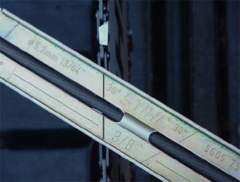

Another tip:
Here is a pic of the inexpensive sharping guide that holds your file. Once you know the correct angle get your wifes finger nail polish and mark that groove on the guide in red. It will stay on there forever. I keep fingernail polish in my tool box for marking stuff!
Sherpa

   / Chainsaw Chain 101 #16
Thats a great idea!
Of course I would have to get a bottle of it out of the bathroom without her knowing it and I would have to choose which red to use.
rose red, sunset red, blushing red, bright red, christmas red, cherry red.............not sure which one would match my Stihl the best. /forums/images/graemlins/grin.gif
