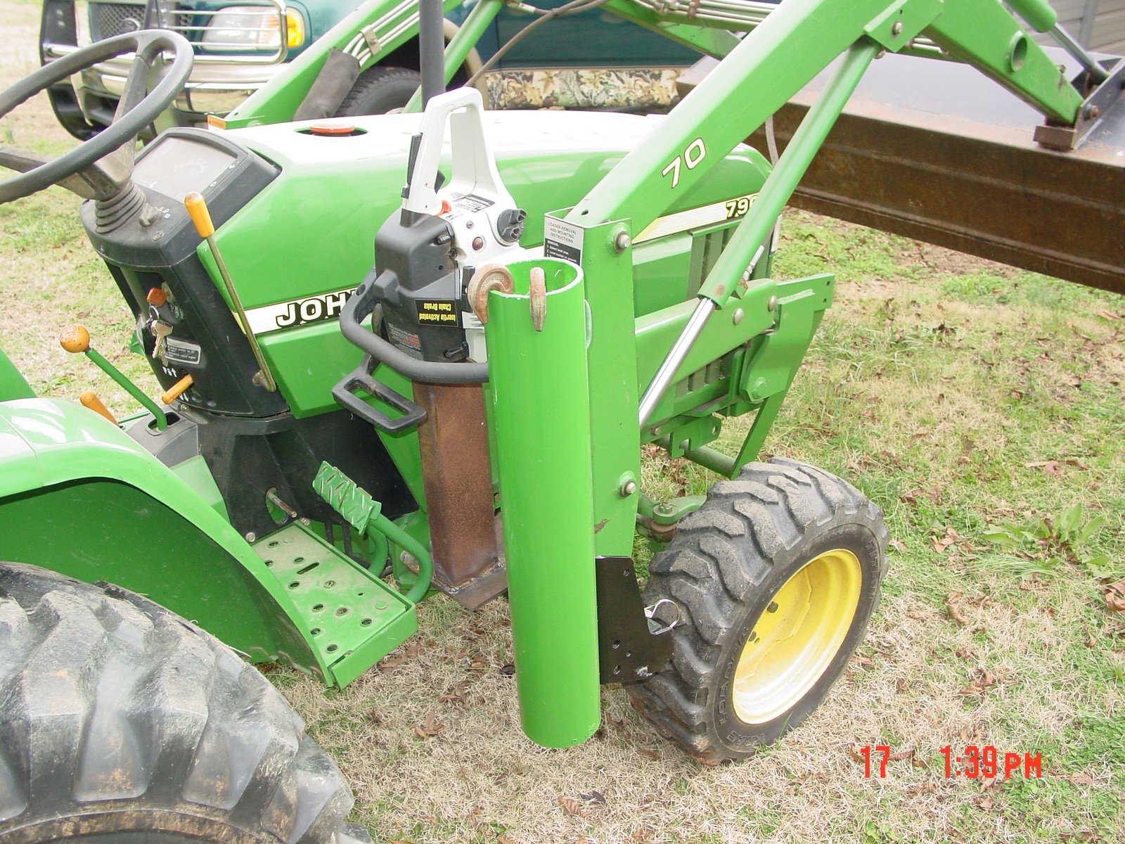

Sorry for the odd shade of green, but was digging around 'todays posts' and I wanted to show off my scabbard. I made it out of kitchen cutting board - that makes this weather, oil and saw tooth proof :)
Here is the scabbard bolted to the loader mount.
with saw
