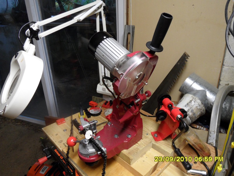

I second the mention about the inexpensive Harbor Freight electric chain sharpener...
I have been extremely pleased with it...
