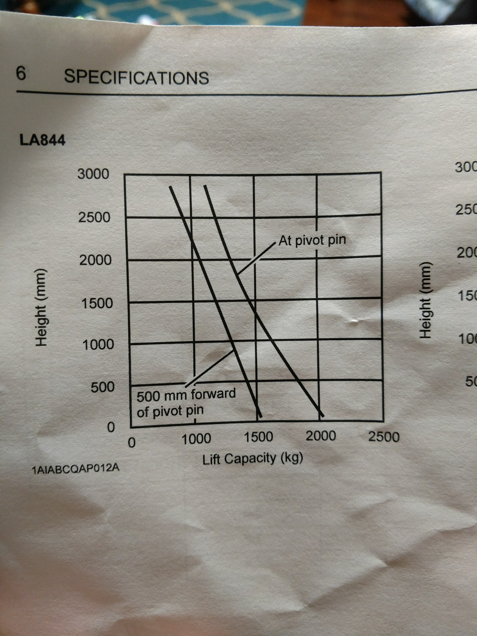

Straight from the la844 manual.
Like I said, it beats the challenge loader. And my suspicion is that the only reason the challenge is rated for more at Max height is because it's a mechanical self leveling loader. Which lessens the "work," required to make a lift

   / "Challenge" brand FEL vs Kubota? #13
I have seen many many loader specs that list a higher roll back force at the cutting edge than breakout. So if it was truly the max force that could be generated, why would it be lower than curl force?
And why in the world would they list a breakout force at bucket pins if it is clearly supposed to be measured at a point 100mm behind cutting edge?
And my manual, the chart for lift capacity in relation to lift height....at ground level matches the spec for breakout force at pins and 500mm forward.
But on any case, it's a moot point. I posted the chart for a la844 loader. It is clearly a stronger loader in the. Bottom half of the range, where you use a loader the most.
Another classic case of getting hung up on just a few specs when comparing and not seeing the bigger picture.
Strength....imo....the Kubota wins.
Resell......imo the Kubota wins
Fit/finish/visibility.....I'm the kubota wins.
Now I don't know the price of the challenge loader???? So don't know how that compares.
If it were me, the ONLY reason I would consider it would be for the mechanical self leveling. But if that's not important for the uses the OP has in mind.....I'd pass and get the Kubota loader
