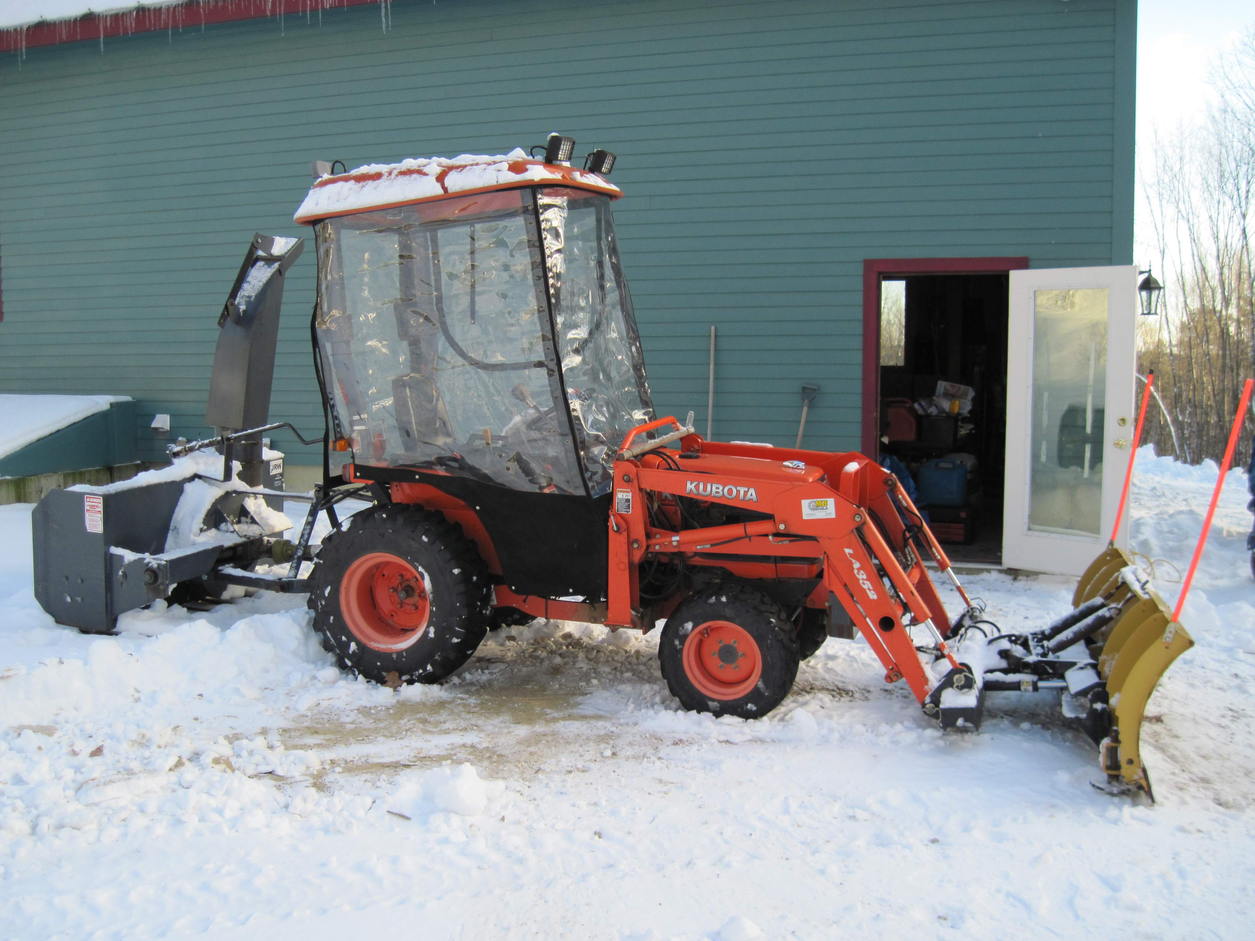

Here is my solution. I have both an enclosed cab in the winter, and the open station in the summer. It works great! I would be too afraid of going in the woods with a glass cab when I am skidding logs. This solves the problem. It is plenty warm, and never have an issue with fog. Matter of fact, after the 1st year with the cab, I went back and had a window added because it got too hot in there.
