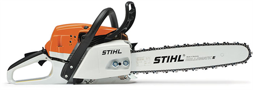

It's been a few years since I checked out the new Stihl line. I have 3 Stihl saws... MS170 for limb trimming (hot knife through butter), my old reliable 026 Farm Boss (2002) with 20 inch blade (rebuilt it a couple years ago due to CONSTANT use) and newer 261 Pro. All have been exceptionally reliable. Went in for some oil and noticed that newer models do not have the anti vibration "split" design for the 261/50 cc models where the cover for the air filter detaches. Have they done something inside and just gone with one poly cover? :cool:

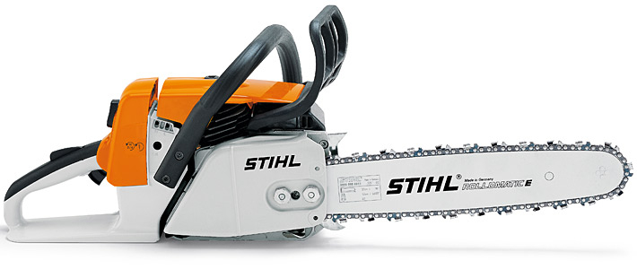

Are you sure you have the 261? The 260 has the pronounced "split" for the air cleaner. The first picture is of the new 261 and the second of the "split" 260. The anti vibration has to do with the handles.

Could you post a picture of your 261 with the split at the filter? To my knowledge, that would be a special model. I have both the 026 with the filter split and a 261 which does not.
   / Change in Stihl design? #6
The 261 didn't come out until 2010/2011, so that may be one way to determine what you have. I bought my 261 when that model first came out. Here's more info on the changeover from the 260 to the 261:
Dreams become reality: The new MS 261 | STIHL | Stihl, Viking, chain saws, brushcutters, hedge trimmers, clearing saws, high-pressure cleaners, lawn mowers, trimmers
If you have a split top cover, it's either an 026 pro or a 260. The 261 has only ever come with the one-piece cover.
The top cover design doesn't really have anything to do with the anti-vibe, and some current model Stihls still have the split design. My 461 (new for 2012/2013) still has a split top cover. From what I have seen, models with the one-piece top cover have superior filtration to the more classic split design.
