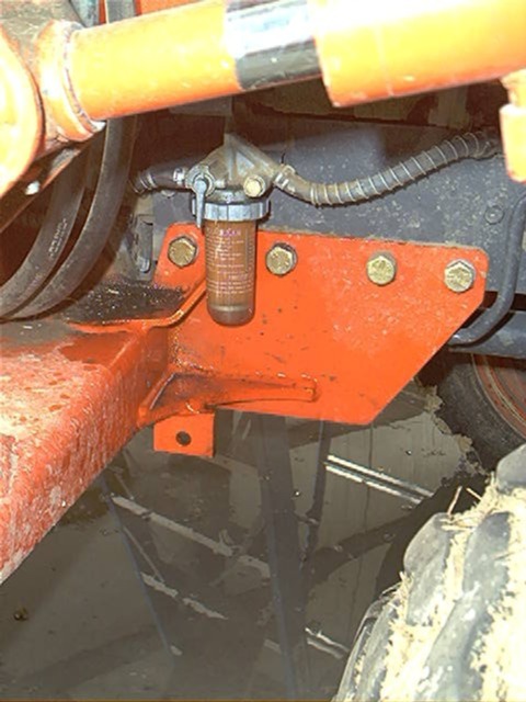

I turned off the fuel cock, removed the bowl and filter and went inside to get the new filter. Came back and there was about a 6' diameter diesel slick on the shop floor. I thought maybe I had not shut it off so turned the lever to the other position (on and off indicated by Japanese lettering) and it really flowed then, so turned it back "off". Still a trickle, which caused the mess. Hmmm..
I put the new filter on and the bowl and mowed about 3 hours today with no problems (except power steering) and no leaks.
Heres a pic.

What a coincidence! I just cleaned the fuel filter on my tractor yesterday. Odd as it may sound, the same thing happened to me, but I had the oil pan under it so no puddle/w3tcompact/icons/smile.gif. I found that the "other" direction for "off" was off and dry. The one I used first was "off and dripping". Did you try moving the lever both sides to see if one was a better seal? That was the ticket for me.
I also had to modify the fuel filter bracket with my 3 lb persuader. Seems it was too close to some wires and "stuff" to allow me to get the filter back on. A couple of well aimed taps and it was easy.

I couldn't tell that there was an "other" position. I'll check that out next time.

You guys made me curious and it was time to change my fuel filter anyway, so I just did that a few minutes ago. Turned the valve 90 degrees counterclockwise, as the manual shows, and the only thing spilled (into a bucket, of course) was the fuel that was in the filter and housing. I left it awhile to see if anymore would drip out and it didn't. Makes me wonder whether you have a defective valve or whether there might have been some debris or something that kept it from sealing off.
