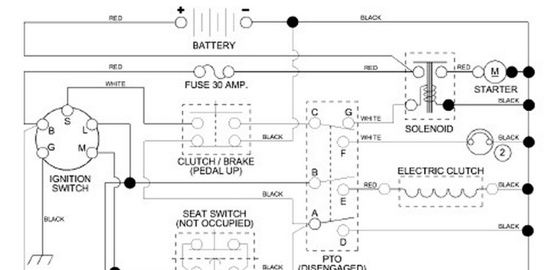

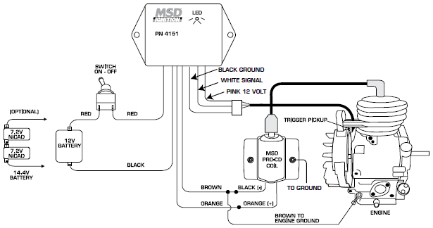

One of the first place I would look is the regulator. A Kawasaki engine uses a different regulator than the Briggs. It sounds like the person that did the engine swap tried to use the Kawasaki wiring for the Briggs. I don't think this is going to work. I have attached two wiring diagrams for the 21 horsepower Briggs engine. Check the wiring on your system and see if it is close.

Thanks LD1, I connected the loose wire to the battery and it seemed to work fine, for about an hour, then the electric clutch just quit. i checked the volts on battery and it is down to 8.20. recharged battery, reading 13.80 volts, mowed for about 30 minutes and the same thing happened, clutch quit! Would it be possible the something wrong with the clutch? If so, how could i test it. I set the air gap to .10, but not sure if thats correct. This has a 21 hsp briggs so i dont know the correct air gap. I called a shop and he could not or would not tell me without taking it to him, and I'm sure for a service charge. Can I get some help?
