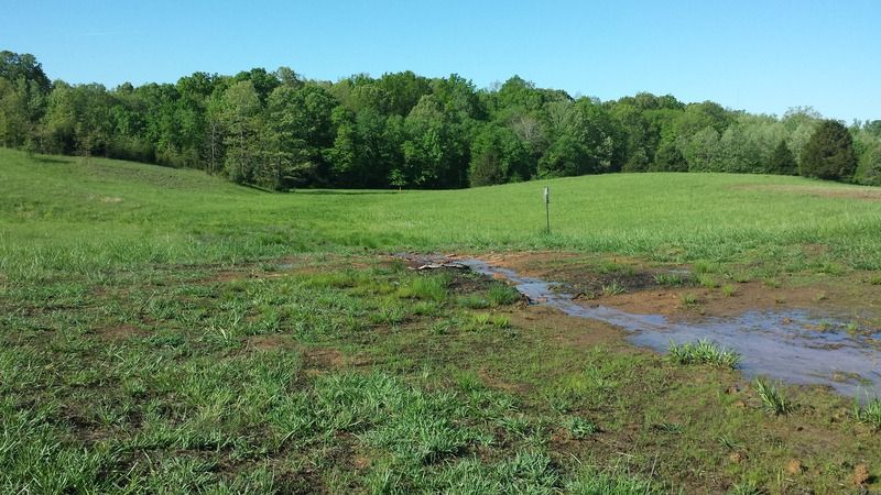

Now over time, the earthen spillway is starting to erode....and in particular out in the pasture ditch is forming.
/ Changing a pond spillway
Pictures to help explain.
Existing spillway. It's 200+ yards through the pasture, with problems all the way from the pond to the woods.

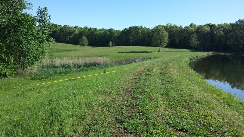

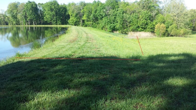

Method 1 with the pipe/culvert in the middle of the dam. The shortest route to the creek. You can see the wet area from a spring that is below the pond.
Method 2. The water ends up in the same place as method 1, taking a longer route....but no disturbance to the dam at all.

You posted pics while I was typing. Sadly, and typically of cosmetic structures, you have NO feeeboard. Without lowering pond level, or raising dam, all a pipe is going to handle is dribble from light rain. This will not help your problem at all.

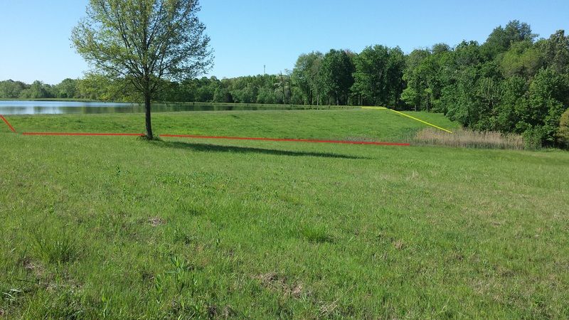

Here is another look at the dam from the back side. The yellow is method 1. The red is method 2.
Ovrszd I think method 2 is 'safer' because of the freeboard you mention. In this pictures, the pond is full...right at the point water would flow out. I would envision the emergency spillway still coming into play with a 2"+ rain.

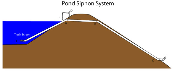

Something like this might help: Conventional Pond Piping System
And: Pond Siphon Systems | Georgia Land Sales Blog

By the photos, yes, you have very little freeboard to work with. Typically the minimum freeboard is 12 to 18 inches from the spillway to the top of the dam, depending on watershed to pond ratio, of course. If the other pond is draining into this larger one, typically the larger one would be designed to hold the volume of the upper one in case it failed and the water rushed into the lower one.
I would still be hesitant to open up the dam and put in a pipe in the center. To put it in properly with anti-seep collars and compacting the fill around the pipe would be a lot of work. Just throwing in a pipe may work for a few years, but eventually it would fail.
Edit - Freeboard not only leaves room for storm water, but it also affects the saturation angle of the dam. With very little freeboard, the saturation angle of the dam is higher and in some cases, the dam may show some weep areas near the toe of the dam at the highest point of the dam as the pond ages.
The longer route would be best. Keeping the pipe away from the toe of the dam, so as not to affect it would be best. Again, after you get out of the toe dam area, you could switch to a cheaper type of pipe or have an open ditch/waterway scenario to reduce the area that remains wet after a storm. Ultimately it is your call. It does not look like there is anything immediately downstream to be worried about in the case of a failure. Get a couple people (contractors) to look at it onsite to get a better idea of the best plan. Photos are nice, but nothing is better than seeing it fully. Good luck, nice property you have there.

One of the reasons I think method 2 is probably better....the inside slope on the dam at method 1 is about the same as the outside of the dam. It's deep there. At the method 2 point, the pond is considerably shallower on the inside of the dam. Look at the outside of the pond in both areas.
