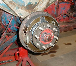

   / Changing brake shoes on Ford 8N tractor #9

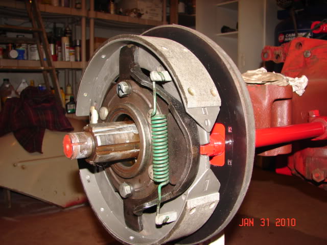

   / Changing brake shoes on Ford 8N tractor #10
here's a better pic
