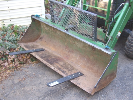

Now that you fellows mention it during the fall season I used to keep misplacing the Kubota in orange and red leafed trees.:D:D
Hopefully Monday I'll get it in for some bucket revisions. Chain hooks, grate across the top of the bucket so logs/rocks/etc can't roll off and come sit in my lap, two truck springs bolted to the bottom as forks and some reenforcement plate on the leading edges of the bucket sides. And a chain hook on the back of the hoe bucket.:)
Just for interest the dealer had the same model tractor only newer sitting in his yard with a tractor hood all broken up by a rock that had rolled over the bucket and onto the hood.:eek:
Everyone is a better Hoe operator that me!:eek:
